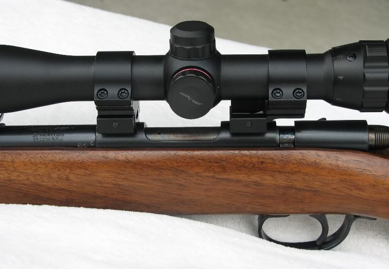

Birchwood-Casey makes a pretty good blueing called Perma-Blu that will do a good job on your old rifle.
For mounting a scope on your 341 use two Weaver #43 mounts on the receiver. I paid my local gunsmith to drill and tap my '42 Sportmaster. It takes a little skill to do it right and I wasn't willing to take the risk myself of screwing it up. Midway USA, Brownells and others sell the mounts for about $6.50 each. Amazon has them too.
http://www.amazon.com/Weaver-Base-To...6574427&sr=1-2
I also use some Medium-Height B-Square Rings with a 1" off-set on the rear ring for bolt clearance. It all works real well on the old .22. I think I bought them on Amazon here:
http://www.amazon.com/B-SQUARE-EXT-R...74143&sr=8-105
Here's a couple of shots of my set-up:
