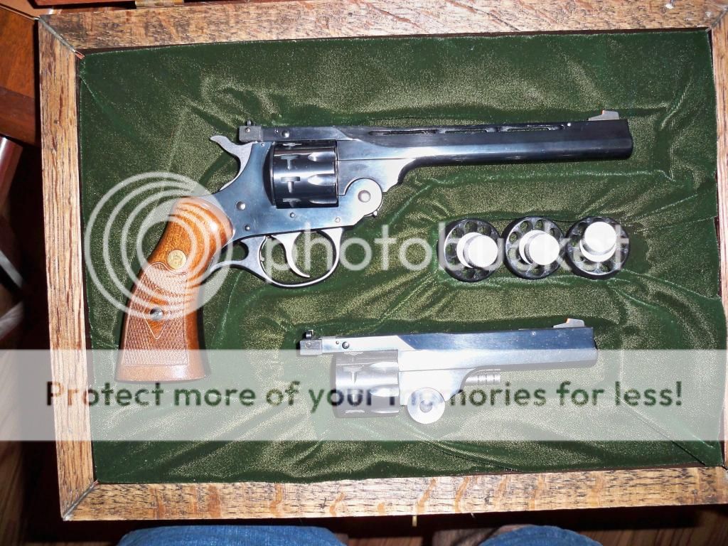

Not sure if you have found the h&r 999 you were looking for.
If not, I have this neat set I am interested in selling;
It is fitted with a 4 inch and a six inch barrrel, comes with 3 speed loaders, and a neat glas top fitted case. Email me at eschuls@carolina.rr.com if interested.
Hope this doesn't violate any forum rules. ;-}
