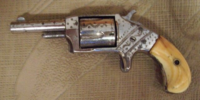

Hello!
I have this spur trigger revolver that may be a Hopkins & Allen made for Merwin Hulbert, or a different manufacturer. I have studied various pics of the spur trigger revolvers of the different manufactures of this period, and I can't pin this one down. It has factory ivory grips, and is engraved in the floral and punch design. Also, the only markings are "DEFENDER" on the top strap and the serial # 727 under the left grip.
Anybody recognize this one?
Thanks!

It's an Iver Johnson. The "engraving" resembles that H&A used, but their spur triggers had a different cylinder pin latch.

Manufactured 1873-1888. Per Goforth, IJ serial numbered 1-99999, then started over, so the number would not really be a true serial number for the total production.

Thanks fellas! Do you think the engraving was done at the factory?

Yes, it is pretty standard "bench engaving", done by a factory employee. In the 1880's, Defender revolvers sold for $1.50 for the .22; $2.60 for the .32, and $2.80 for the .38. Engraving cost cost a whole $.25 extra. (For comparison, the Colt SAA was $14.)
