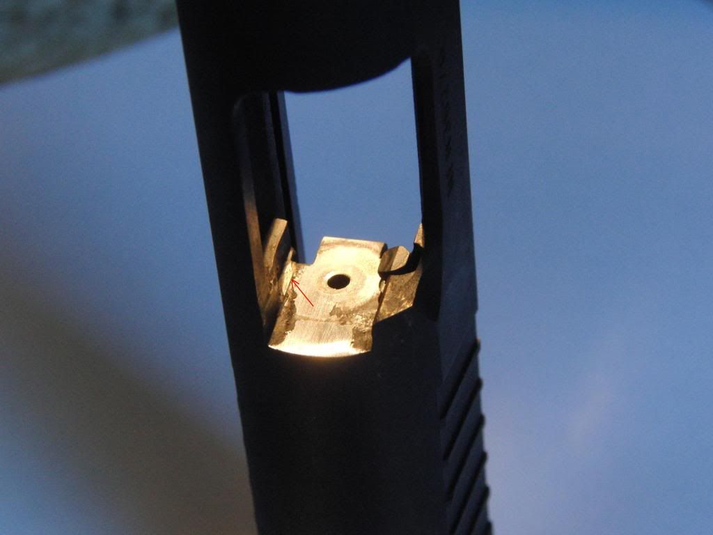

I finally was able to get to the range 6-12-2012. I loaded 4 clips and was shooting at a bucket at around 30 yards.
The Taurus hit the bucket several times, and then started shooting low.
I picked up the fired brass and found that the head of all of the fired shells were marked
and the primers appeared to be hit off center again. Shot a target at 25 yards and the impact was 12”low.
The mark on the head of the shell corresponds to a raised area on the slide battery surface. See picture
http://i166.photobucket.com/albums/u...firedround.jpg
My gunsmith Justin Davis (JDK Professional Gunsmithing Middleton, ID) was the one that spotted the raised surface,
he also commented about the barrel link marks and poor filing job.
He also found that the rear sight set screw had fallen out, and that the Sight was too loose in the groove.
I am getting the opinion that this pistol is a lemon. I will be sending it back again.
I have the feeling that it should be replaced with a "tested", new PT 1911.
This Taurus PT 1911 has been nothing but a bad experience.
I expected a good shooting 1911 from Taurus. I am not looking for a National Match Grade Bulls-eye shooting machine,
Just a fun shooting gun.
I understand some things go wrong, but it seems that each repair is a little worse than the last repair,
and the original problem still exist.
I am including picture links so you can see the poorly machined slide battery face, marks on the fired cases, and barrel link. These are High Resolution Pictures.
http://i166.photobucket.com/albums/u...lideface-1.jpg
http://i166.photobucket.com/albums/u...shellarrow.jpg
http://i166.photobucket.com/albums/u...llinkright.jpg
http://i166.photobucket.com/albums/u...ellinkleft.jpg
http://i166.photobucket.com/albums/u...iredrounds.jpg
