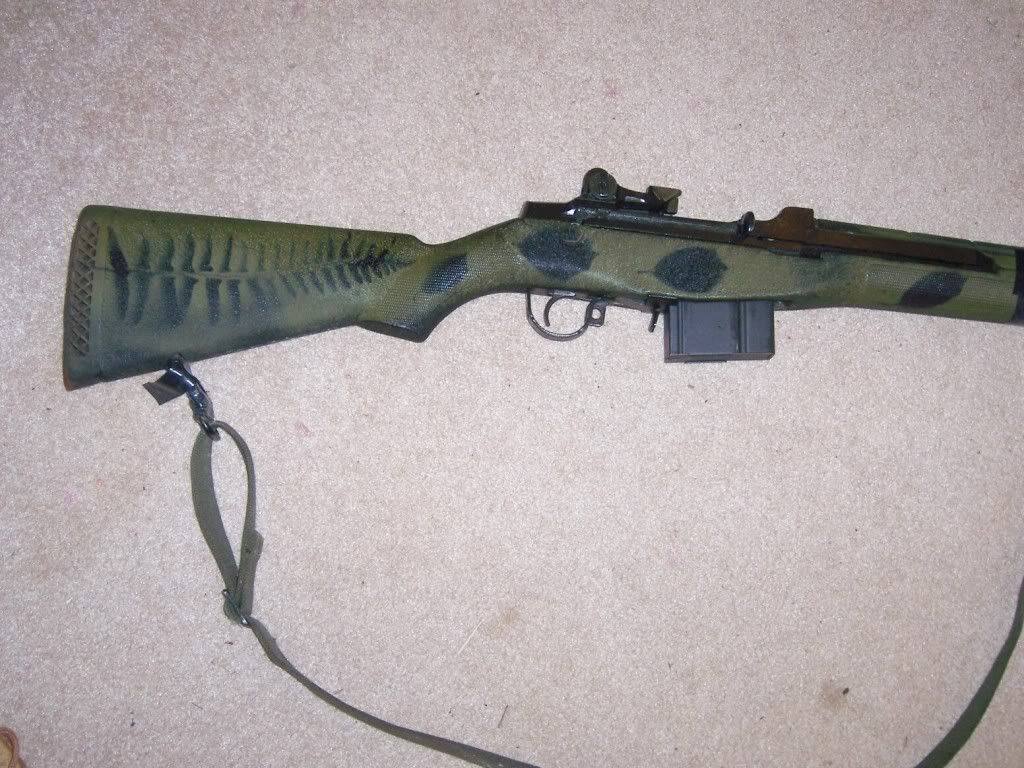

I scuffed mine with a scotchbrite pad and used the Restolum for plastic paint. You can also use the textured paint as well for a little more grip. I went to Micheal's and got some fake grass and leaves to make stencils. Or go to walmart and pick up a pair of fishnet stockings that makes a good pattern for a camo job.
Here it is on my rifle.

That turned out really well! I've heard of some tape that you can get that has no adhesive on it, but sticks to it's self. Easy to put on, easy to take off.

That's a work of art there, nice! I really like the "textured-type" on the finish!

I'm not real happy with the end results and might take GunHuggers and Snakedrivers advice on the subject and re-do it before it does have time to cure to much.
The first mistake was start it in an open building with HIGH humidity.
After seeing how the base coat was going on, I got a bit into a panic mode and rushed the job....I was looking for a more of a flater finish and may still
yet, go over it lightly with some fine steel wool and go for a more-of-a duller
finish.
