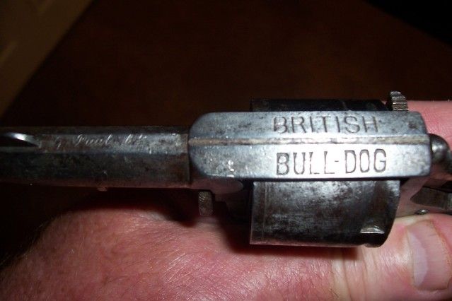

Hello!
I have just finished working on this British Bulldog revolver, but I don't know much about the markings on it, or the caliber. The chambers are just slightly too small to accept a .32 S&W cartridge. It is a 6-shot, DA only. The left side of the barrel is roll-marked "PARIS". The top barrel flat has the engraving "g. Paul, e??". The right side of the barrel has upside down engraving " C. ?. Magenta, ?08". It has the Liege British proof mark of E over LG over a star, in an oblong circle with no crown on top. (black powder proof for rifles, ??) There is an R above this symbol. Anyone have any info on this beast? Believe it or not, this revolver functions and locks up nice and tight.
Thanks!

There's no such thing as a "Liege British" proofmark. The ELG in oval without a crown indicates it's pre-1893 Belgian and proofed in Liege, Belgium. Thousands were made by anonymous cottage industry workers 1870s-early 1900s. The "Paul" and "Magneta" marks may have been retailers.
If it's centerfire, caliber is probably .32 Short Colt/.320 European.

hrf,
The "Blue Book Of Gun Values" lists that symbol as a British proof mark, proof house in Liege. Is this a typographical error?
Old Gun Guy

Absolutely an error, typo or otherwise!

hrf,
Thanks for the info. BTW, a .32 short colt fits the chamber perfectly.

Unless they moved Liege when I wasn't looking, the book is in error (I think they got their page headings mixed up). British revolvers had conventional trigger guards, not folding triggers.

Well light my fire and call me smokey, that goes against every thing I knew about proof marks. Well, I guess the next thing you will be trying to tell me is that the world isn't really flat.

Jack, I know you are far more familiar with British and Commonwealth guns and the gun trade than I am, but are you saying that British authorities were authorized to put Belgian proof marks on guns? That is contrary to everything I know about European proof practices, and seems totally absurd. It also seems impossible, again from everything I know and have read, that the UK proof houses would allow their marks to be used outside their houses and indeed outside the country.
A proof house is a fairly complex operation, not just someone with a stamp and a hammer, and to establish proof houses all over Europe would be a very expensive proposition. And why not in the U.S., which did, and still does, a thriving arms trade with the U.K.?
I wonder if there is not some misunderstanding of the "bond" system, where materials are brought into a country physically, but placed under bond until they can be given any required approval or markings. But that is common commercial practice and doesn't require any proof houses to be established on foreign soil.
As to guns imported into England, at most times, Belgian proof was recognized and British proof was not needed (and vice versa), but at other times, guns imported from Belgium were proved in England and have both sets of proof marks, or Belgian-made guns were exported without proof and proved in the importing country. (U.S. guns were always proved when imported into England, because the U.S. has no government proof law and no recognized proof specifications or marks.)
Again, with all due respect, I think the explanation of a simple typo in the BB is more reasonable and more likely.

I must stick to my guns also, as your gun is Belgian, made in Belgium by Belgians, and proofed in Liege by Belgians.
There were a few quality Belgian gunmakers, but because of the mass of low quality, low cost guns turned out by unnamed sources, their reputation suffered, and no British maker or retailer would want their products marked to indicate made in Belgium!
On the contrary, in an effort to compete with the lower Belgian prices, even Webley and other British firms obtained some guns in the white from Belgium, had them proofed and finished in Birminghmam, and marked with their name.
Blue Book is more interested in book sales than accuracy, and I have advised them of other errors that they never bothered to acknowledge or correct.
