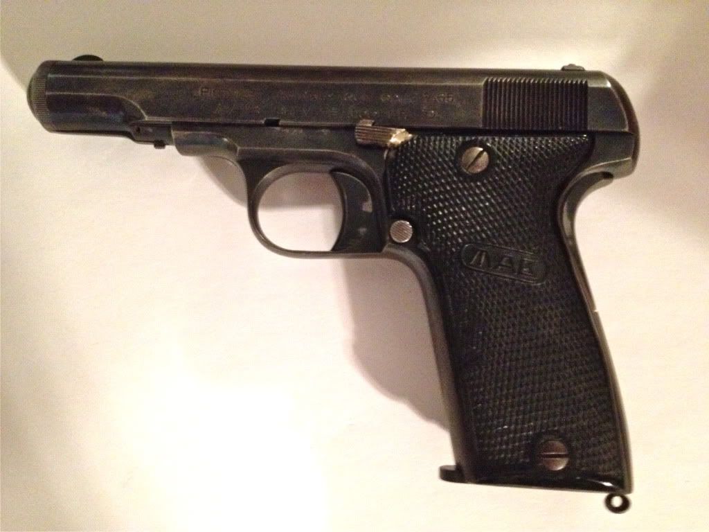

It's time for my ADD mind set to run wild , so this should be interesting. I have an old MAB Model D that has a story for me and is in need of being fixed up. This relic has been in previous topics (my posts as well as other peoples post; but not the same gun.. there are more than one) as I have tried to work out some bugs. My intent here with this post is to have a log of what I will be doing as I try to go through this firearm and build, fix, restore, call it what you will, to my personal liking. Does this gun have any real world vale? To some collector, probably not, to me... This gun started my intrigue with firearms, the internal lock works (monkey motion) and has taught me a life time of gun safety in the process.
Well Im sure I'll bore you with more stories later. Lets get started.
O.K. the French (stop laughing) Pistolet Automatique CAL. 7,65 (.32 ACP) MAB Brevete Modele D, a spin off of an older Browning handgun this model was manufactured back in 1933 until about the 1960's. For more details on its specifics, there are a few websites that do a better job of explaining its history... Im no historian, just a mechanic .. so ill leave that to the pro's.
This is a simple blowback auto loader, hammerless, and all steel construction less the rubber grips.
In my next posting Ill try to make an "exploded" view using the parts of the gun all laid out. This might help other people who have one of these, locate parts, their location, and possibly their function. So if any one does have one, feel free to make comments. I will also most likely be asking for advice and suggestions as I go along.

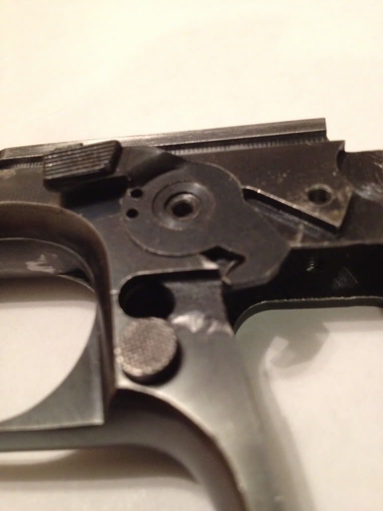

The safety lever has been repaired with silver solder. You will not be able to properly blue it. You can darken the solder, but it generally rubs off.

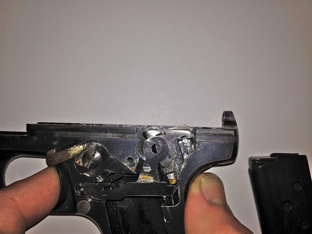

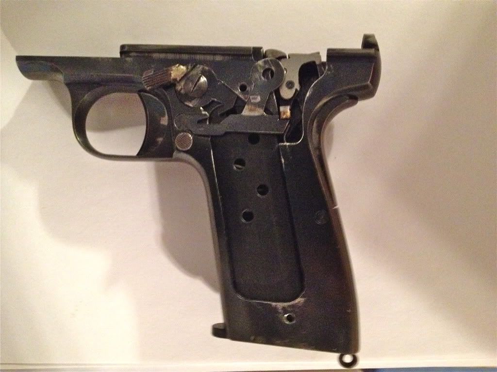

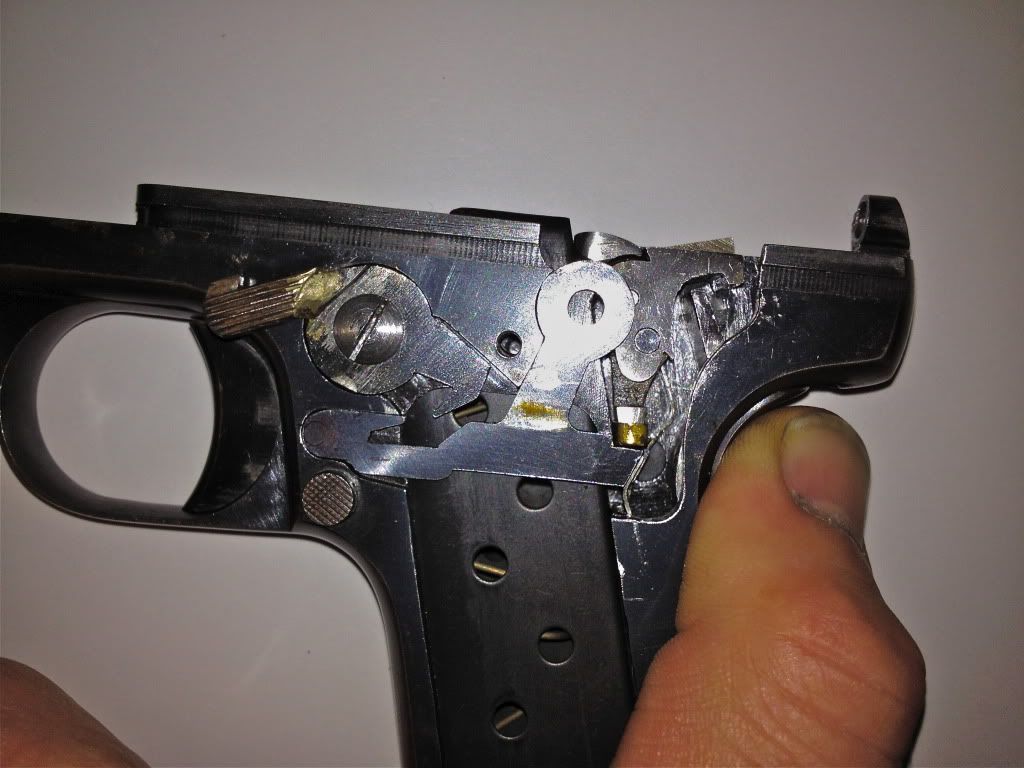

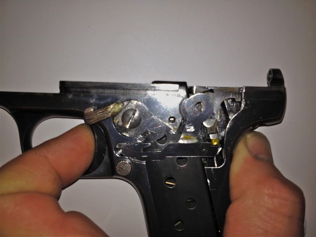

Well, I was going to get into why I started this rebuild, but first, I have some pictures that show how the monkey motion in the frame works. Please forgive me for having my hand in the pictures, and don't yell at me if my hands are dirty!
The first pic is of the frame.. with magazine in place, if you look at the top and rear of the magazine, you'll see the safety cam/sear assembly. This firearm is great (my opinion) in the fact that back in the 30's they had the insight to use the magazine as part of the safety. Im sure this is no break through for this gun for the day... but its still cool. The magazine will hold the forward section of the cam in an aft direction, forcing the sear to pivot on a different pin within the cam.. making the sear drop when the trigger is pulled. Also.. if you look at the back of the cam / sear assembly, you will notice it has a boss on the lower side that is blocked by the grip/palm safety.
Here we have the magazine in... and the grip/ palm safety is depressed; note the size of this gun as compared to my hand... (who did the french build this for.. the oompha-loompas?) any way.. with the palm safety depressed.. the sear block moves forward out from under the safety cam /sear assembly allowing for the sear to drop.
Now..with the mag in place, the palm/grip safety depressed, and the trigger squeezed back, the trigger connecting rod / sear disconnect moves the lower portion of the cam assembly, and with the mag holding the cam in an aft direction, the sear can only move down releasing the firing pin (not in pic). The sear disconnect comes into play when the slide cycles aft.. pushing the trigger connecting rod / sear disconnect down off the lower portion of the cam assembly. (here its depicted with a brass shim which I have since removed)
And finally... with the mag out... and all other configurations set for shooting, you'll notice that instead of the safety cam / sear assembly moving down releasing the firing pin.. the safety cam moves forward preventing the gun from firing.
Any how.. that the "magic of the monkey motion" inside the frame of a MAB Model D... You guys still awake?

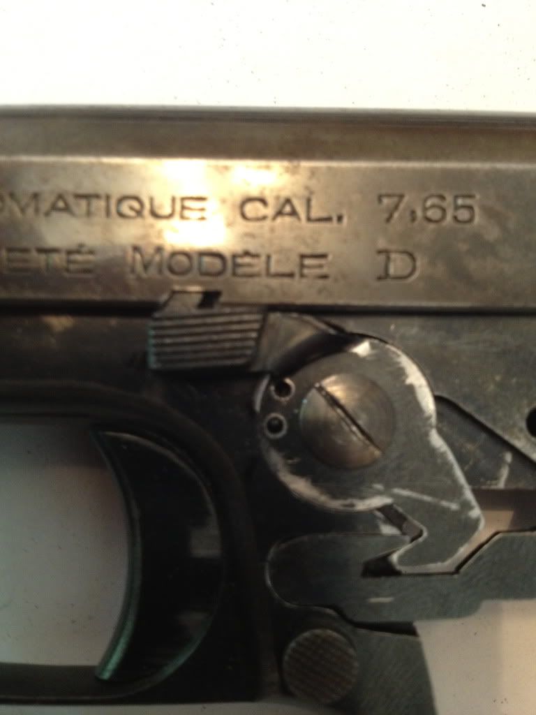

So, this MAB was my first purchase of a centerfire firearm back when I was 21.. I came across it at an antique shop when I was on the road while working. I saw this sleek looking gun sitting next to a German Lugar P-08... being new to guns back then... and seeing the P-08 had no magazine.. and the MAB was by far easier on my wallet I went with the MAB; Silly me.. should have went with the P-08.
Well Im sure you can figure out firearm lesson #1, I learned when I purchased it... "What do you mean I cant walk out the door with it?" Lucky for me I had an old acquaintance that was a gunsmith/ FFL holder back home. So I had my first ever centerfire firearm sent to Elmer Brace. 3 months later... I got back home and stopped by Elmer's place... learned all about the paper work involved in registering a firearm... lesson #2.
Wait until I tell you how he "fixed" it for me when I couldn't get it to feed with the magazine it came with. That story just might be buried somewhere in this forum.
Well Elmer Brace unfortunately is no longer with us.. So I have resorted to tinkering with this gun ever since... hence my interest in firearms now.
Well, Here I have a picture of the MAB, and if you study the picture you can see that the thumb safety has been silver soldered back together. It was like that ever since I purchased it.
Some one in one of my previous post mentioned that I may want to change it. So thanks to the internet, I found a brand spanking new safety lever. Now the original one was a solid steel machined part (I love billet things) and remember this MAB is a Type 1 (first series) the New lever is a stamped steel part.. with the metal folded over to thicken it up at the lever end, I will ASSUME that this would be for a Type 2 (second series) MAB.
Now this image is a bit fuzzy, but if you study the new lever, its a bit tight in the recess and wont actually fit flush to the frame. Now with some T.L.C. jewelers files, a sharpie to "darken the filed areas" (for making rub marks stand out when rotating the part in the boss) and a bit of patience...
I got this for my "lock up" although the trigger and slide wouldn't move at this point... we are after all after a SAFE firearm.. so with more T.L.C. and patience.. I got this. And I cant get it any closer with out damaging the new lever.
This configuration, engages the spring loaded detent pin underneath fully, locks the trigger transfer bar / sear disengage bar tightly (NO movement at the bar) and Keeps the slide from moving rearward. Now I know there is a small gap at the rear of the lever on the slide, but the slide can not move any further forward because of the barrel. So unless one of my new gunsmith friends out there really thinks I'm screwing something up or this configuration will fail... this is how I'm leaving the safety lever. Now all I need to do is prep it for a finish. Still debating on that. Bluing or parkerizing?
