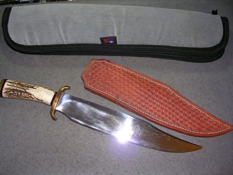

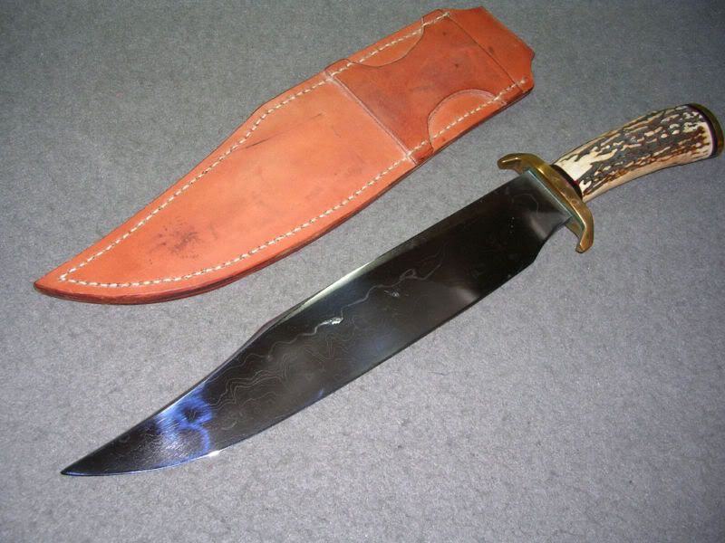

I am in the market for a nice hand made Bowie and was wondering why Makers like to use Damascus steel so much is it mostly becasue of looks or is there a spicific reason? I found this knife that I like and it is Damascus steel ...

Well guys just an update on my Bowie knife quest ...I did buy this knife and should have it sometimes this week. The knife is unsigned but this was how the seller wrote up the discription.
Offered for your consideration is spectacular and unusual hand forged custom damascus bowie knife. The knife is completely unmarked although I have an idea of who the maker may have been. This is an early damascus knife that was likely made in the late 1980's, when only a handful of custom makers were following Bill Moran's lead. The knife comes from a high-end southeast collection that was assembled from the late 1970's to the early 1990's. This collection included knives from some of the top early innovators in the custom knife world and some of these knives were among the first knives to find there way into my personal collection. The collection held many knives from some of the most talented makers in the southeast, primarily Georgia and Florida. One of these makers was Durrell Carmon Johnson, whom I strongly suspect made this knife. Johnson spent roughly four decades as a blacksmith and knifemaker. This is a large, gorgeous bowie that was beautifully crafted. It's very unique in that the blade was mirror polished. Damascus is generally acid etched to bring out the contrast of the layering or grain. The grain is clearly visible in this blade, although from a distance it looks like regular mirror polished steel. It's a very interesting effect that makes for an awesome knife. The massive blade was skillfully forged and is 1/4" thick. The blade appears to have been forged to shape and shows excellent symmetry with very little grind work. The damascus exhibits a beautiful random pattern and one side of the blade shows two small forging voids. To me this adds character and adds to my suspicion that Johnson was the maker. He once told me that he didn't even have a power hammer until like 1990. He said his damascus was forged with "my right arm and three-pound hammer". The clip was aggresively ground to facilitate sharpening of the upper edge should the owner so desire. The blade is exceptionally sharp! In fact, it's razor sharp and will shave with ease. The edge will cleanly wipe the hair from a forearm. The double guard was sculpted from solid brass and was beautifully executed as well. It shows excellent symmetry and the design is somewhat unique, with the top and bottom of the handle side angles shaved to about 45-degrees. This allows the top side of the guard to be used as a thumb rest. The blade was perfect centered with the guard and the blade/guard junctions are very clean. They were silver soldered with a skilled hand and show a seamless fit. The handle is phenomenal section of Sambar stag. It's exceptionally thick and really fills the hand. The natural shape of the stag was exploited to offer a firm, comfortable grip. There was very little shaping of the stag, with just a small area near where the index finger meets the guard that was flattened just a bit to improve comfort. The shaped surface was deeply polished and is as smooth as glass. The stag is very rich in both color and texture. It has a classic appearance and is rock-solid. The pommel is of thick brass as well and was perfectly shaped to match the contour of the stag.
Despite its impressive dimensions, the knife handles beautifully. It feels great in the hand and doesn't feel awkward or unwieldy at all. It's nicely balanced and offers nice blade control.
The blade is 11-3/4" and the knife measures just under 17" in overall length. It weighs in at just under 1-1/2 pounds.
The sheath is the original and was hand crafted as well. It was made from thick leather and was solidly built. It was tooled in a basketweave style and has an unusual belt loop that would allow for traditional (vertical) or horizontal (although I can't figure out why) carry. It's free of any cuts, tears, loose/missing stitching, or any other damage, showing just some soiling from storage. The knife also comes with a large padded zipper case for storage.
If you appreciate fine, handmade custom knives, this is a very unique, heirloom-quality knife that will be treasured through the generations.
A huge, gorgeous, and early custom damascus bowie!!
