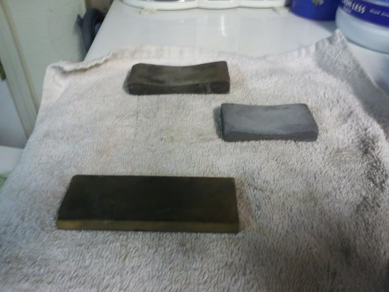

Ok so I am in need of a new sharpening system.
I've used since I was a boyscout the same set up. 2 different natural stones, one of them is 2 different grits. So 3 grits through the 2 stones, then onto a whetstone. Both the natural stones are shot. They are about 1/2 gone in the middle. I can still get a decent edge off them, but it takes longer than it used to, and not near as good as I used to get them. I used to test them by shaving a section of hair off my arm. I worked a knife the other night, and didn't get anywhere close to where I wanted it.
I can't seem to find the old natural stones anymore, so what should I get.
I've looked at the lansky, and it seems to be a good system, but I really like doing it by hand.
And there is so many types now. I don't know what to get. I just expected to go get a new stone.
Any suggestions on what to look for?

You can flatten your stones on automotove wet/dry silicon carbide paper. Tape the paper to a flat surface, and rub the stones on it until they are flat again.

Thats a good idea Bill, and it might work on the little one, but I'm not sure about the bigger one

All you need for those stones, is some warm water, and a little soap! Wash them good, I use a vegitable brush, and let them dry.
You think I just need to clean them? That simple? Hell I thought I needed a new one. Ok, I'll washem up and see if that does the trick. Mighty embarrassed if thats all it is

The 2 smaller stones appear to be carborundum- man made stones available from Norton. You can even scrub them on the sidewalk to flatten them.
