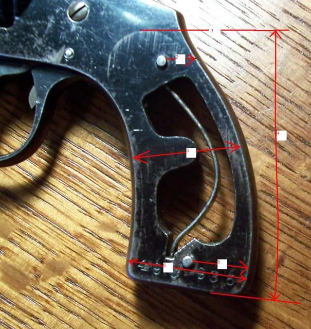

I have an H&R Premier small frame top break .32 S&W caliber. It is serial # 496935, which puts it in the second model, seventh variation. Unfortunately, this is when they changed the grip frame to where there is no step down for the grip panels to fit into.
My question is; does anyone know if any other model of H&R top-breaks used this same grip? I have been unable to locate the correct grip for this revolver so I'm beginning to think that there aren't too many of them out there.
Any help would be greatly appreciated.
Old Gun Guy
Old 07-15-2010, 12:43 PM   #14
oscarmayer
Join Date: Jun 2008
Posts: 2,387
Default Re: H&R "Premier" 32 Double Action Revolver
have you checked www.vintagegungrips.com ?
Old 07-19-2010, 02:38 PM   #15
Old Gun Guy
Old Gun Guy's Avatar
Location: N. Utah
Posts: 489
I got alot of assistance from Vintage Gun Grips. However, after looking through all of their H&R grips, they were unable to find the correct ones. I'm back to square one on this, and would appreciate hearing from anyone that may have this particular grip on hand. Here are some pics of what the back strap looks like (no stepdown for the grip to fit in), and measurements at different points.1- Disregard
2.- 1/4"
3.- 1"
4.- 2 3/8"
5.- 1/2"
6.- 1 1/8"
Thanks!
Old Gun Guy
according to numrich arms, they list these grips as parts number HRPW2 but they may no longer be available (old catalog).
bill

jim is right i would like to see a picture of your revolver and the box.
bill
Thank you Jim and Bill for taking the time to post to my questions. My gun does look like a second model auto eject second variation that you mentioned Bill. I will try to post some pics or at least send them to you guys so you can post them for me. I'll try and get that done this afternoon. You'll see the serial number does have a prefex letter before the 1424. It looks like a "Z" but more like the number "7". The end of the box does look like what Jim's picture shows but only says Automatic Double Action and it does list the barrel as a 3-1/4". The pictures will show you better. The action does not work too well, it will only cock with some effort. Some times the DA works and sometimes it doesn't. The gun has a lot a wear to it. I would say it would be quality wise about 60%. Can I get either of your emails in case I have problems posting the pictures? Thanks a lot.
Mark

Here's four of the pics that Mark e-mailed. Others to follow:

And here's a couple more of Mark's pics. This is a good series to see first hand some of the features and locations of s/n as Bill notes in his descriptions.
