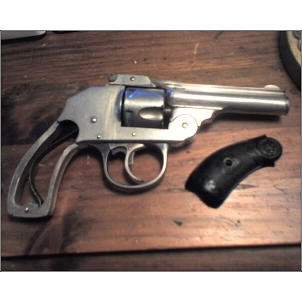

Hi,
My father gave me a small pistol that was his grandfathers. He thinks it is from the late 1800s. I'm curious if anyone can tell me more information about the pistol. My father knew very little about it. I have attached a photo and below are all the details I can find on the pistol:
On Top of barrel:
Iver Johnson's Arms & Cycle Works
Fitchburg, Mass
On bottom of grip:
PAT June 16.96 AUG.25
Inside grip:
S57786 (possibly S59986)
It is a 5 shot pistol with each chamber being about 3/8" in diameter. Sorry if I am not using the correct terminology.
Thanks a lot for any information.

klongfel,
this revolver is a iver johnson's arms & cycle works second model (1896-1908) small frame 'safety automatic hammer revolver'. the "S" letter code was used in 1907 and 1908. serial numbers S57786 and S59986 were both made the same year 1907. all second models (1896-1908) were manufactured for black powder cartridge pressures and are not considered safe with modern smokeless ammo.
bill

klongfel,
kthe caliber is 32 S&W (not the 32 S&W Long).
bill

goody,
the chambers are described as being about 3/8" not the bore. the letter code 'S' was only used on the safety automatic revolver in 1907 and 1908 on the small frame 32 S&W centerfire. iver johnson's arms & cycle works used different letter codes for different calibers and different frame sizes and even different ones for hammerless models. some of these letters were used several times some only once. "S" was only used in those two years. the small frame safety automatic revolvers were only available as a 7 shot 22 rimfire or a 5 shot 32 S&W centerfire. the six shot 32 S&W long was not offered until after 1909 (in the third model) and it was only offered in the large frame versions). this is not guess work but some of the information i obtained from the factory in 1983 while researching for my book on iver johnson's arms & cycle works. also to the trained eye there are diffenences in the large and small frame models. the picture furnished is a small frame.
bill

INFORMATION NEEDED TO IDENTIFY
IVER JOHNSON’S ARMS & CYCLE WORKS SAFETY AUTOMATIC REVOLVERS
1. EXACT MARKINGS;
A. TOP OF BARREL
B. LEFT SIDE OF BARREL
C. BOTTOM OF BUTT STRAP
2. SERIAL NUMBER FOUND ON THE LEFT SIDE OF THE GRIP STRAP UNDER THE GRIP PANEL (MAIN LOCATION SINCE 1896). THE SERIAL NUMBER FOUND ON THE BOTTOM OF THE TRIGGER GUARD WAS ONLY USED AFTER 1904 AND SINCE TRIGGER GUARDS ARE INTERCHANGABLE AND THIS LOCATION DOES NOT HAVE THE LETTER CODE IT CANNOT BE USED FOR PROPER ADINTIFICATION
3. BARREL LENGTH;
A. STANDARD BARREL LENGTH FOR LARGE FRAME IS 3 ¼ INCHES
B. STANDARD BARREL LENGTH FOR SMALL FRAME IS 3 INCHES
4. HAMMER SPRING
A. FIRST AND SECOND MODELS SINGLE FLAT LEAF
BLACK POWDER MODELS
B. THIRD MODEL CAPTIVE COIL
SMOKELESS POWDER
CALIBERS:
A. FIRST MODEL LARGE FRAME HAMMER OR HAMMERLESS 38 S&W (5)
FIRST MODEL SMALL FRAME HAMMER 22 RIMFIRE, 32 S&W (5)
FIRST MODEL SMALL FRAME HAMMERLESS 32 S&W (5)
B. SECOND MODEL LARGE FRAME HAMMER OR HAMMERLESS 38 S&W (5)
SECOND MODEL SMALL FRAME HAMMER 22 RIMFIRE (7), 32 S&W (5)
SECOND MODEL SMALL FRAME HAMMERLESS 32 S&W (5)
C. THIRD MODEL LARGE FRAME HAMMER OR HAMMERLESS
32 S&W LONG (6) AND 38 S&W (5)
THIRD MODEL SMALL FRAME HAMMER OR HAMMERLESS

rogermac,
the patent dates listed were used between 1903 and 1905, this infor and the pictures confirm this is a second model hammerless. however the Letter code T was not used until 1907/1908 and then on the hammer model. is it possible the letter code could be a badly stamped J which was used on the second model hammerless between 1903 and 1905. if so your revolver was manufactured in 1903 and designed for black powder only.
SECOND MODEL SAFETY AUTOMATIC HAMMERLESS REVOLVER
(Black Powder Cartridges)------------- -–1896-1908
LARGE FRAME AND SMALL FRAME VERSIONS USES HAMMER THE HAMMER ACTION: Double top post barrel latch, Hammer the Hammer action, nickel finish with blue optional, two frame sizes and three calibers. Hard rubber grip panels with Owls head at top. Calibers: small frame .22 rimfire with 7 rounds cylinder capacity, .32 centerfire with 5 rounds cylinder capacity; Standard barrel length: small frame 3 inches, large frame 3 ¼ inches; Weight: small frame with 3 inch barrel .22 rimfire 12 ½ ounces, .32 centerfire 13 ½ ounces, large frame with 3 ¼ inch barrel 17 ¾ ounces; Height: small frame 3 ¾ inches, large frame 3 7/8 inches; Frame length: small frame 4 3/16 inches, large frame 5 inches; Overall all length: small frame with 3 inch barrel 6 3/8 inches, large frame with 3 ¼ inch barrel 7 3/8 inches. Main serial number location on left side of grip frame grips must be removed to see. The Second Model features a double top post barrel latch, flat leaf hammer spring and two cross pins in the lower frame.
VALUE: 100%=$285 60%=$150
