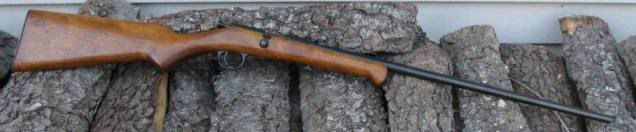

Here are a few of mine I have collected through the years. Grew up shooting one.
mjfitting is offline   Reply With Quote
