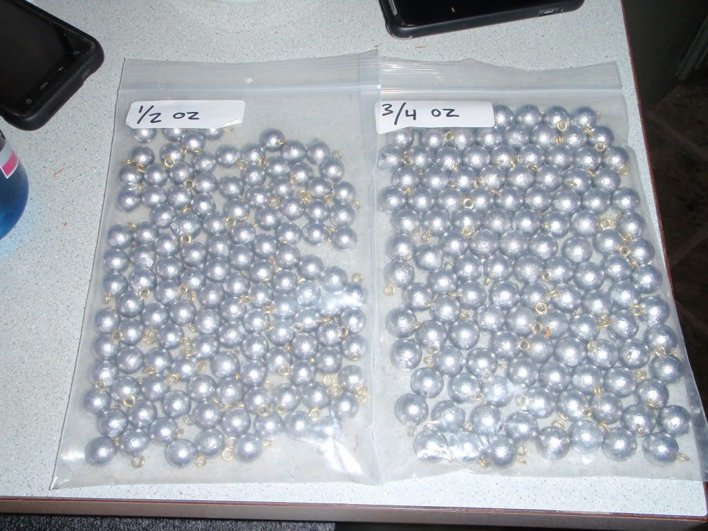

and have to sneak this photo in there, finally got to try out my new fishing weight mold, ran outta weights at the river yesterday going after the kings; did about 250 total, 1/2 and 3/4 oz cannonballs, Do-It mold 5/5 cavity;

Those are some right pretty bullets and sinkers. What caliber bullets, 45/70?

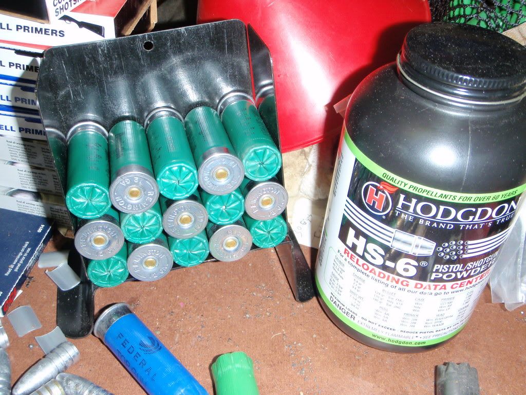

OK, I can't stop taking pictures of my reloading crap. This thread makes me realize how badly I'm addicted; anytime I stroll into the shop for anything, I wind up turning one of the progressive loaders a few times, or getting sidetracked into organizing or sorting brass, bullets, etc... The 12g 9000 MEC is always set up with my skeet loads and I bought another 1000 pack of .40 FMJ's to load so the Dillon is munching out .40 cal still.
Made some more 12g slugs from my home cast Lee key drive 7/8oz mold this morning, 38gns of HS-6 with a WAA12L wad (petals cut off). Ordered a roll crimper, should be roll crimping these bad boys next week! Messed with the finish crimp adjustment to try and get it perfect, most are good, a few were less than ideal. I must have a couple hundred of these loaded up now, next trip to the woods will equal a slug-a-palooza!

Thats awesome. Last night I finished loading up some #5 shot upland loads. cleaned primer pockets on over 500 38sp shells and started priming them. Broke my kinetic bullet puller while pulling some bullets. The cap that holds the metal piece broke off darn I have to go shopping today sorted out my last haul of range brass after it finished tumbling.
