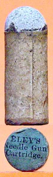

Your top gun was made by Jean Jacques Rissack between 1850 and 1857 in Belgium. It is a needlefire gun, probably .32 caliber (.32 needlefire). It is the most valuable of any of these.
Here is the patent for it:
And here are a couple eley needlefire cartridges.
As well as a sectioned one:

Here are some more needle gun cartridges.
From left to right: The Dreyse needle fire cartridge for the German Dreyse IG M1841 rifle, The French 11 mm Chassepot Mle.1966 Needle Fire cartridge.

I've never seen cartidges like those for the needle fire. Fascinating!! The education never stops.

Very interesting on the needle-fire. That explains why the hammer appears to be attached to the firing pin, necessary for withdrawing the needle before the breech can open.
