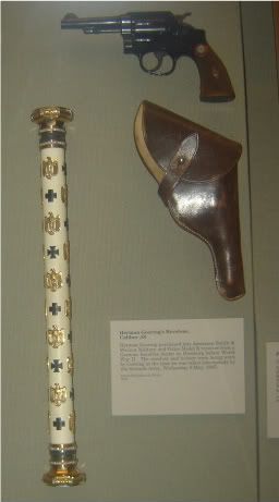

A point that might be of interest. Herman Goering carried a S&W Military & Police model revolver that he purchased from a dealer in Hamburg prior to WWII. He is found wearing it in many photographs. He was wearing it when he surrendered and it is now in the West Point Military Museum.
David
very interesting! I'll see what happens tomorrow and post up what I find.
Old 08-02-2010, 05:23 AM   #6
Posts: 8,662
Default Re: Victory Model Capture gun?
Hermann Goering's M&P

The Marshalls Baton is one of Goerings and is with his S&W in the West Point Military Museum. Another of his Marshalls batons is in the National Infantry Museum at Ft. Benning and is velvet covered and of the same color as the pale blue uniforms he wore at times.

In regards to Mr. James comment that the Reich had no source for .38 Special etc....Goerings' M&P model was purchased prewar and certainly had access to ammunition. There is no reason to believe the the most highly industrialized nation in the world at the time was not capable of producing ammunition in any caliber they found necessary. Here is a document which includes 2 Colts and 200 rounds of ammunition. (Bottom) It only stands to reason that ammunition such as indicated in this document was captured in quantity along with weapons.
There is a third revolver listed under item "C" (12 mm) That would have been another Colt. They referred to .45 cal interchangeably as either 11mm or 12mm.

(Göring's S&W revolver was a commercial gun, not one captured from U.S. or British troops. Presumably his ammunition had been obtained before the war.)
