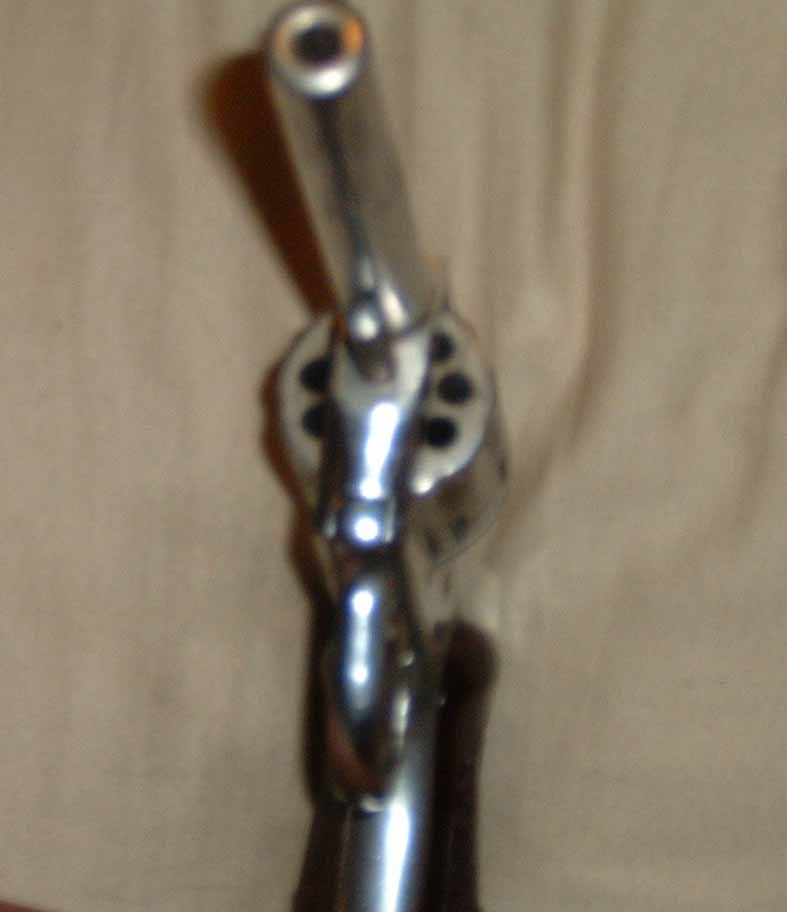

Here's a pic it's not that great but as you guys can see this is not a swing out cylinder. There's no lever any where and some how the pin and the cylinder should come off to load and unload.
lou3469 is offline   Reply With Quote
Old 08-16-2010, 11:44 AM   #8
Jim K
Posts: 6,408
Default Re: H&R 923 How do I remove cylinder?
AFAIK, that model has a pushbutton cylinder pin catch in the frame in front of the cylinder. I can't see it in the picture, but it should be there and pushing it in (to the right) will allow the cylinder pin to come forward.

Some years did not have a push button or lever to release the cylinder pin.
You simply pulled the cylinder pin straight out.
The pin was held in place by a ball detent. (think, ratchet and socket)
If pin won't move, it is probably corroded, rusted, dirty.
jamesjo is offline   Reply With Quote

Jamesjo is correct. The picture shows a 2nd Model. It probably has a serial number starting with the letter prefix N, P or Q. The early 2nd models, starting in 1953, did not have a pin latch - they were held in place by the detent as Jamesjo describes and can be identified by the location of a pin located just above the cylinder pin and running from side to side of the frame. Identical to the Model 922. Rust is the probable culprit.
