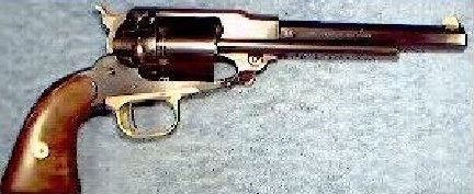

Here is my American pistol. Was wondering if smokeless powder cartridges can be used with this model.
