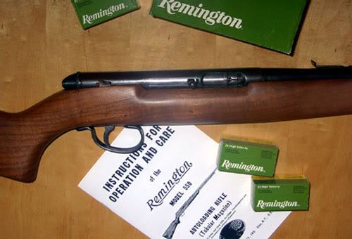

Just finished restoring my Remington 550-1. Just waiting on Numrich to send the firing pin and rear sight step. I should have gotten a before picture. It was in very bad shape. I took the stock down to bare wood and soaked it in water to fill the wood cells. Then took an iron and wet bath cloth and steamed out the dents and gouges. Just left a few so as to retain some of the character that a 60 year old rifle would have. Put on two coats of Tung Oil. The metal is okay, 50% of the blue is gone and left a nice brown patina. Bolt works great and can't wait to see how it shoots. I know they are renowned as very accurate and reliable rifles. Larry

NIce!
You did't "deminsh" the value of this .22; you brought it back.

Very Nice!
I have one that was given to me years ago when my uncle passed.....I'd love to get a manual like you have pictured, are they available from Remington?

http://stevespages.com/pdf/remington_550.pdf

That's just flat out NICE Larry! And agree with 22shot, you brought it back.

Thanks guys, for the kind words. You all know it was a labor of love. It's so gratifying to see it come back in little stages. All the while wondering what it will look like when it is finished. I have to wonder about anyone who doesn't love these old guns.
1969SS396 the link that trap55 gave us is where I got the manual. Just printed it out and folded and stapled it.

Great job, the woodgrain is pulled out nicely! Got any more pics, she's a beauty!

Amazing work... What was your method for refinishing the stock... I have refinished many for friends and family, even a few outsiders... But mine are mostly a very glossy very personalized 22lr. (usually Marlin)... I tell the owners that I am about to kill the value of the rifle that they bring me, so I try talk them into purchasing inexpensive rifles from a Pawn Shop... I will post some pics... But, I have a few that I have attained over the years that I refuse to customize... Will post some pics if I ever figure out how...

You did a realy nice job on the stock.
However please don't reblue the metal parts. There is something about the old 22rs that have character when you see the worn blueing and all the minor nicks and bruses.

I take it down to bare wood and then sand to 220 grit. If the grain looks a little pale, I'll put on some dark walnut stain, let it dry over night then wipe it down with mineral spirits. That way the grain get a little color. Then I use a good quality Tung Oil and wipe it on by hand, usually two to three coats. That seals the wood and protects it and gives it a finish that looks 50 years old but new at the same time. Here is the Remington 514 that my father gave me when I was 10. It is 57 years old. My father told me to take very good care of it and I think I have done so.

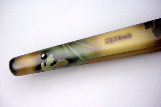

I do some airbrush also. Here's a picture of my deer rifle stock. Air brushed then finished with three coats of Marine Spar Varnish matte finish. That's my old Army division patch on the pistol grip.

Those are absolutely beautiful... Thanks for the pointers on the original look and I appreciate your comments on my work... Couldn't make out the patch, which one is it?

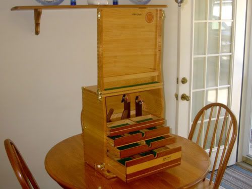

I built a pistol box and finished it with 3 coats of Helmsman Spar Varnish and wet sanded to 800 grit and then hand rubbed it with a felt pad with rotten stone and oil. It is beautiful and just about everyone wants to know how I got that kind of finish on wood. I say, do a lot of reading and then prepare for a lot of elbow grease. I'm sure you agree.
The box is made out of cypress. I planed the wood to 3/8" to hold down the weight. The white in the target is basswood and the ring is mahogany. The bullet holes are purple heart. This first picture is before I put on the brass corners or even before I cut the door. The second one is the finished box. The drawer fronts are mahogany with basswood trim.

Beth, they are in post #13. A Remington 514 and also two photos of a camo stock I did. Larry

Awesome pistol box Larry. Definitely makes mine look like amateur work (which it is). Not only do you have a .22 I'm envious of but now you're gonna make have to go back to the workshop and try and build a better range box. I was already thinking about finger joints when I finally got around to the next one. Wow!!! is all I gotta say.
