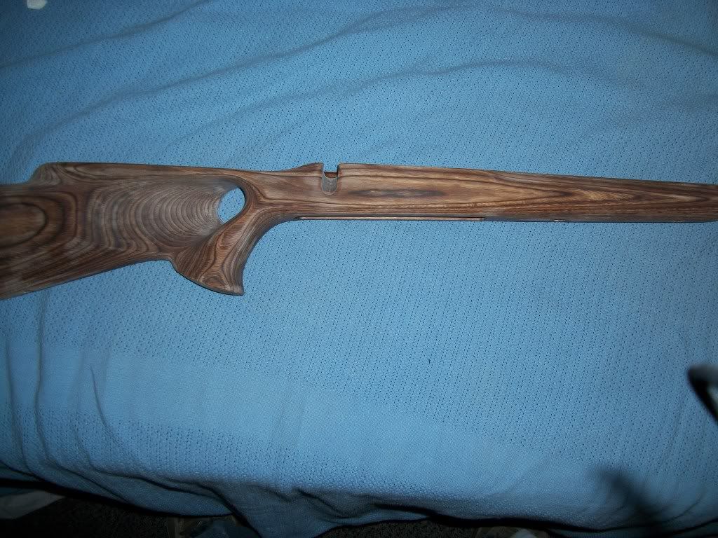

Hi gang! awhile back I got a deal on a thumbhole stock that was cut for a CZ452 varmint. The rifle I have is a 452 special, and since both rifles have a barrel lug they mount in the stock the same way, at the same points. I got this stock for about half retail, so I couldn't pass it up! So when it came in the mail I was thinking I was going to have to do some woodwork, turned out to be a straight drop-in fit! So off to the range to try it out, had to play with torque settings, ended up with higher settings than with the original stock, but it shoots great! The only problem was it looked like they sprayed one coat of urethane on the stock for a finish! That was not good! So one night I was looking at it, and before I knew it I had sanded the finish off the stock! Took
about 45 minutes, this is what it looked like before I attacked it, ,
It was pretty lite in color, after sanding,,

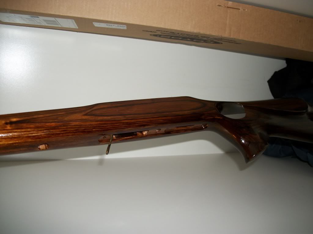

This is the stain applied before wiping off,,
This is after five coats of tru-oil',

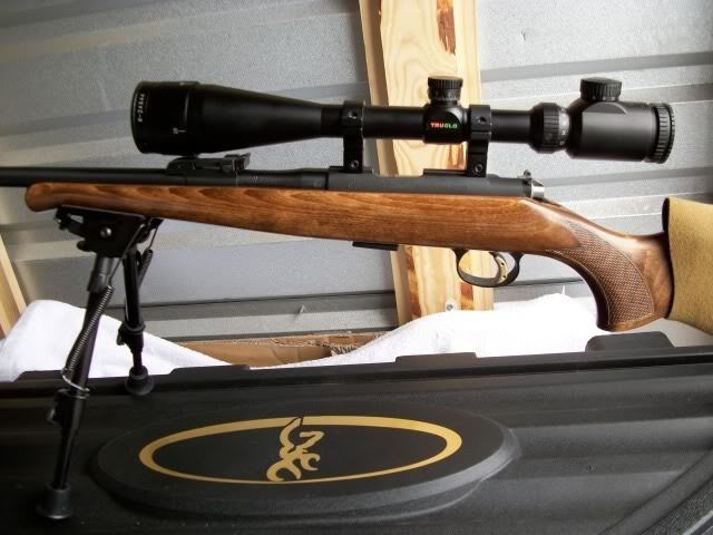

and this is the finished stock with the rifle back at home! this is 20 coats of tru-oil and wet sanded with 2000 grit paper then polished with a product called plast-x, it is a mild abrasive that breaks down quickly, works good on this kind of finish for a nice satin finish. This is what I like to do for a side line, I have good rates and a lot of experience doing this. But I have fun while i'm doing this as well! Doug

Real NICE! I'd say with 20 coats of tru-oil, you have you a life long finnish!
Time consuming, but well worth it in my opinion.
Nicely done, job well done!

Nice job. Most people can't be bothered to put on more than one or two coats of oil.

I know a lot will stop after maybe 7 to 10 coats, but what they don't realize is10 coats of tru-oil is only about .006" thick! So it is worth taking the time to put enough on to make a better finish. and the more coats you put on, it
starts to take on a 3-D effect, at least it looks that way to me! Doug

I guess I have a habit of doing this, when I got the rifle the original stock looked like it had been painted with dark brown paint! I could see it had some nice grain to it, so off to the hardware store for some stripper, and the finish on
it came off! The difference was the CZ factory finish was TUFF! It took four applications of stripper before I got it all off! So I stained it and put ten coats of urethane on it. I don't have a before pic, I didn't have a camera at the time. but this is how it came out, ,
It looks better than it did! I had the urethane on hand, that was why I did the stock in that instead of tru-oil, finished the finish the same way 2000grit paper and scratch-X, works good! Doug

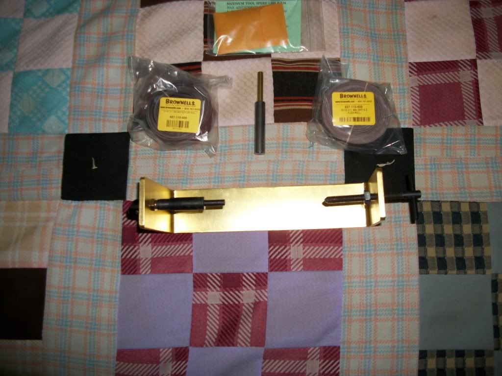

Doug, is your fixture shop built? If so, I'd like to see how you did it. Larry

Basically what it is, is a bracket with an arbor that one end of the bolt is centered on, and a screw that on a centerfire bolt with the firing pin hole in the center would center on. On a rimfire all that has to be done is use a spent shell, and you have a hole to center the bolt on!. This is the set-up,,
As you can see it is a simple fixture, this one was made by B-square. As I mentioned Wheeler used to make one that I saw when I was living in AZ. The gunsmith, was simi retired but just couldn't keep his hands off it completely!
I'm going to get some 280 and 320 grit wet or dry sandpaper, it will help with the polishing of the bolt body, I will photograph each step as I go along! The bracket is a little warped but it is straight along the length, and that is what matters, couldn't make a straight line otherwise! Doug

Thanks, Doug, looking forward to seeing your progress. Looking at your rifles, it's obvious that you are a stickler for details. I agree, a jeweled bolt really sets off a rifle.

Since this is my first attempt at this, I might just get a 7/16" piece of steel pipe and do a practice run to see how it comes out! That way I can see if there are any places in the procedure that might catch me up, I would rather ruin a $1.00 piece of pipe then the bolt body for the rifle! Doug
