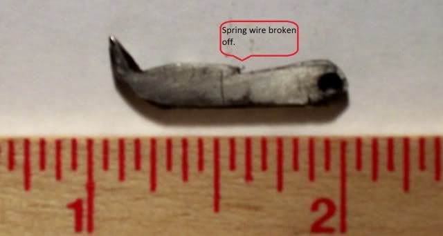

I have a Sportsman that I inherited from my grandma. Here is all of the info:
1: D26572
2: Hammer Mounted Firing pin
3: Safety Rim, 2 Pat. #'s:1904730 & 2034632
4: 1" lever release
5: Address on Top
6: DA
7: Adjustable
I am having firing problems with it. I think I need a new cylinder. When I cock the hammer, the cylinder doesn't quite line up with the barrel and has sent lead shavings out of the side of the gun. Any ideas where I would be able to get a new cylinder?
*Edit: Updated with Pictures
TYIA,
Fatty

FattySparks, others here will be able to tell you more than I can, but until they come along I can tell you this: You don't need a new cylinder as a whole, you need either a new ratchet (which is part of the extractor star, and removable) or a new "hand", which is the part that come up out of the recoil shield to push the ratchet and so rotate the cylinder.
Even more of a problem than finding parts, though, is getting them fitted properly. Adjusting these parts so that the firing chambers line up properly is called "timing". As you might expect, having nine firing chambers makes it harder on this revolver than on most, and finding a gunsmith who is willing and able to tackle it can be tough.
Fortunately, you have come to just the right place to find such a person. I will let the more knowledgeable members address that question. HTH!

It is the ratchet, but most places that I have checked only sell the cylinder as a whole piece. I bought one from numrich, but they gave me the cylinder for the design with the push button release, not the 1" lever.
Can you tell me what year my gun was made?

As Lanrezac stated, it's more than likely the hand/lever that is worn to the point that it won't push on the cylinder ratchet far eough to line up the chambers with the barrel. These early model 999's have a different shaped hand/lever than the later models do. Here's a picture of what it looks like with the spring wire broken off. Let me know if this is what you need, and I'll see if I have one to send to you. ( A good one with the spring wire attached)
Old Gun Guy

In an attempt to not clutter up this thread, I have created a new post that has some pictures and some more info. Please take a look and let me know what you think.
http://www.thefirearmsforum.com/showthread.php?t=106201
