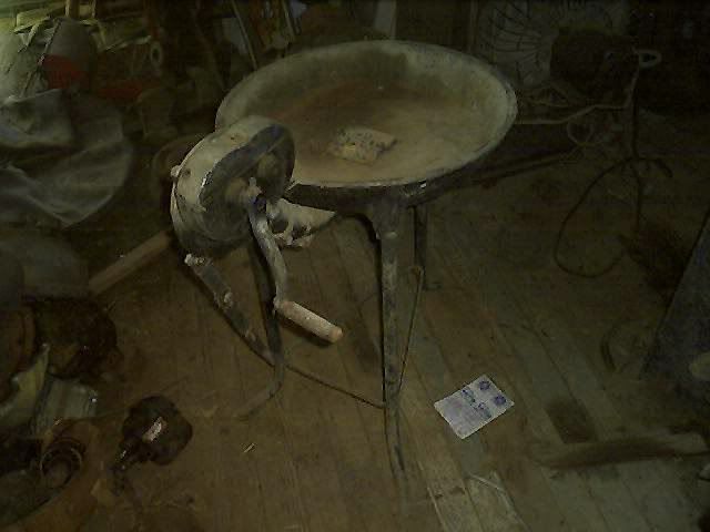

I've got an old forge I've been wanting to do something with but never seem to get around to it. The pan is cast iron and talk about heavy. I do need to take the blower apart and clean the hardened grease out of it. It barely turns now. When dad first got it one little crank of the handle and it seemed the blower would spin for five minutes, course that was close to 40 years ago.

Sometimes at farm auctions you can pick up a complete forge, anvil blacksmith vise and tools. Contact some of the rural auctioneers or look on the internet for auctions. That picture of a forge is like mine. Easy to fire up when you take the notion. As several have said, truck leafsprings are a good source of steel. You'll need a grinder, hammers, files and punches also. A cross peen and a straight peen hammers will help you stretch and thin the steel. Get a book and enjoy an ancient craft.
