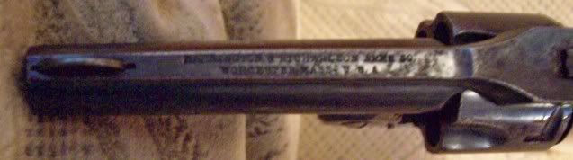

    Bill,
    Can you give me an estimate on manufacture date on this H&R 2" snub?
    Serial #182,836 found on left frame under grip and on bottom of butt.
    836 on rear of cylinder.
    Rib marked "H&R Arms Co. Worcester, Mass. U.S.A." (two lines)
    Side of barrel: 32 CAL. S.&W. CTGE.
    I need to know if this is a C&R or Antique.
    Thanks,
    Dean

    the 2 inch barrels on any of the small frame hammerless model are kinda of rare so there fore information on them is limited. they were serial numbered in the same series as the regular hammerless model. serial number 182836 falls into the C&R catagory manufactured about 1910 to 1913. it can be asummed that any H&R with a six digit serial number falls into this class as H&R revolvers maunfactured before 1899 will have only 5 digit numbers or numbers with a letter code and 5 digits.

    From your listing I would say it is a Fourth Variation as there are no patent dates and the barrel rib markings are in a small font.

    I have a small-frame hammerless H&R .32 S&W. It is a second model, and I believe the fourth variation, serial # 204257. The pictures aren't too clear because my camera is on its last leg. The top of the barrel is all small font, with no patent dates. All numbers match, and there is a pronounced "H" under the top strap that I tried to get a picture of, but failed. Is this one of the scarce ones?
    Old Gun Guy

    except for being blue with mother of pearl grips this appears to be standard production manufactured between about 1916 and 1924.
