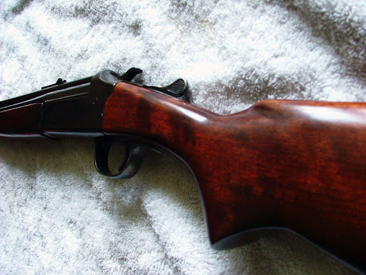

    I'm not a chemist or professional gun smith, but I do have some experience with Blue Wonder. My father took a gunsmithing class in college 50 years ago and restored / customized a beautiful Spanish Mauser in 7x57 as his deer rifle. He hasn't really done any gunsmithing since then, but he is an engineer and is very mechanical.
    Last year as part of an indoors "winter project" he decided to restore a Steven's 22-410 that he has had for over 50 years. He looked into hot bluing it and found that it would likely cost more than the rifle. He knew that cold bluing doesn't hold up so well, but he came across Blue Wonder with the tagline "It's not hot blue, it's not cold blue, it's Blue Wonder." He watched several of the demonstration videos online and though he would give it a shot.
    He has been very impressed by the look and durability of the finish. He even blued a piece of steel from the trigger assembly and then carried it around with him all day rubbing it like a worry stone and polishing it with different types of cloth. This had no noticeable effect on the finish.
    I don't work for the company and your results may very, but this was his experience.

  4. LurpyGeek
    LurpyGeek Active Member
    Nov 30, 2005
    1,436
    UT
    Actually...
    He has the Stevens 22-410 pictured above, and he also has a Savage that is almost identical (Savage bought Stevens shortly after the one pictured above was made).
    The Savage (a model 24 I think) is chambered in .22 magnum and .410 shotgun. It's in pretty rough shape as was the Stevens, but he plans to fix it up similarly in the spring and sell it.
