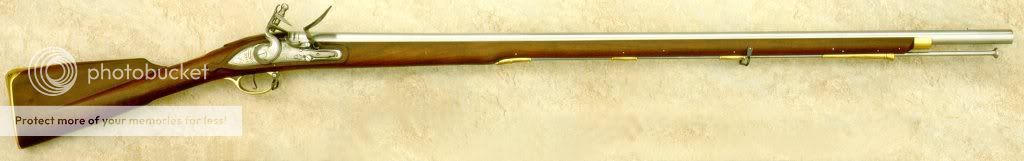

    Hello - this is my first time on the site. This flintlock has been in a friend's family since the mid-1800's (I'm in Ontario, Canada). It appears to be a Brown Bess but is strangely lacking in markings. Total length is 57 inches, with a 42 inch barrel. No words (tower, etc) anywhere on the lock. On top of the barrel, at the rear, is stamped something that resembles a flower, and below that a clover (maybe) with two crossed swords or something beneath. No other identifying marks. There is no brass plate on the left side where the screws hold the lock in place. .75 caliber, I believe.
    Any help in identifying this gun would be appreciated. Here are some photos -

    Well, it is not a Brown Bess. There is no sideplate and the trigger guard is wrong, plus there is no crown or maker's name on the lockplate.
    I may be wrong, but I think from the markings that it is a type not uncommon to Canada and the northeastern part of what is now the United States, an English trade musket. These were made in England specifically to trade to the natives, formerly known as Indians, in return for furs and other goods and for support against the French. They were always fairly serviceable, though inferior to the standard British army issue Brown Bess. Some were deliberately made with soft parts so they would wear out and the Indians (oops, native whatevers) would have to keep coming back with more trade goods to swap for new muskets.

    Thanks for your reply, Jim. I had my suspicions. The lock does not fit very nicely into the stock, for one thing. However, it looks just like a Brown Bess lock. Was there a generic type that resembled that of a BB?

    agree with jim this looks to be a Stanfield not a Tower or Grice , the lockplates of the majority of bess's .. and Stanfield would be one of the most common trade guns , the engraving though.. i dunno if that'd be a indian lock i'd say a settlers gun or so..

    A differing opinion from the loyal opposition. I make it to be an English contract Sea Service ca. 1800 musket that has had lock markings removed/changed, has had its foreend wood removed (sporterized, if you will). Sea Service arms are similar to the standard arms but made cheaper by omitting such frills as brass side plate, with screw heads directly on the wood. Marks on the barrel look like Birmingham. Brass butt cap and triggerguard are typical English military. As plausible scenario might be that it became surplus and was sold as a trader to the redskins in Canada. Nice that it seems to remain in original flint.

    Jack, I never saw a Bess without a sideplate and with that shape trigger guard. It could be a militia musket, but I hold out for a trade gun. Those trade muskets were made to look like the regulation musket ("See, Chief Running Bear, we are giving you the same guns as our redcoats carry...") but were less well made and less costly.
    A neat gun, and it likely has a real history if we only knew it, but it's not a Brown Bess.

    Jim K - You are right, not a Brown Bess, maybe not even an English military. It looks like a contract Sea Service musket. Sea Service pistols and muskets as well as other English military ( navy, sea service) items were a significant part of English armament from about mid 1700 to mid 1800s. Like the Brown Bess series some maybe most were contract made for the Gov't. Many were made for private sale to expeditions, etc and did not necessarily conform to exact gov't specs. The trigger guard is a quasi-copy of the standard Brown Bess but seems to lack robust detail (may be the photo). Lack of a frizzen link (from pan to frizzen acrew)is a typical simplification typical of Sea Service and contract pieces. Barrel length of 42" is standard for the 2nd and 3rd Model Brown Bess and may be one of them, either legit or a gov't reject. Google has a mess of stuff about Sea Service muskets and pistols.

    lots of military look alikes in them days , as jim stated and other reasons , many rich people converted bess's into fowlers , such where the reputations of arms and arms makers back then
    however the US gun makers started to out do in practicality and weight, the formidable euro guns ( french and english mainly ) and make their own name , but not be so stuck up about it ;)
    my vote is generic english or scot's ( the scots had a big influence in canada and north US in the settlement days ) trade gun , indian or settler i cant say, the scroll work leads me to think settler or such , but not a bess and i doubt military
