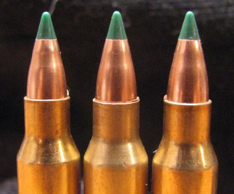

    I found my precision load consisting of 26.2 grains (.2 grains above max load) of IMR 4064, 55gr Blitzking, with an OAL of around 2.209 inches for my Remington 700 .223. Just to get this out there, this is a compressed load and the powder comes right about the the bottom of the neck of the brass. When I pressed 20 rounds last night I noticed a little indent just down from the tip of the bullet. Will this affect bullet flight much? I believe it's because the powder is touching the bottom of the bullet and thus causing a little more force on the seater die, putting the small indent in the tip of the bullet.
    Haven't shot these yet so last question, would you guys go with them and try to shoot them or is this too dangerous? Start all over and save powder, use the bullets for a lighter load for p-dogs or something of that nature? Thanks for the help guys!!

    I think you are talking about the ring made by the seater plug. You can fix that by taking the die apart and chamfering the seater plug and polishing it up a bit so it doesnt mar the bullet.
    The loads will shoot fine. That little blemish aint nuttn if you think about what the barrel and the rifling are going to do to that bullet when you fire it. The barrel will cut 6 grooves along the shank of the bullet in a spiraling pattern appx .008" deep and the bullet, if the load is good, will still hit where the crosshairs say.. ;)

    I notice most people say blemish or ring, here's a picture for a reference. I've had where the ring kinda shows up and you can see where the seater was touching, this is an actual indent around the whole bullet and on some you can even feel a slight rib or shoulder almost. You can really see it on the far left one.

    The Blitzking is one of those thin-jacketed bullets.
    Hornady's SX and the Speer TNT lines are the same way.
    Yeah you might get those dents on occasion when a bullet seats harder than usual. I get them every so often if I don't get the bullet set square on the case mouth or if I hadn't chamfered the case mouth quite enough.
    I notice that the center round that you've got pictured has a slight ring of jacket shaved off of the bullet... If you're shaving the jacket then those thin-jacketed bullets will distort too.
    You're fine to go ahead & shoot them but it depends on your rifle whether or not it'll affect the groups.
    Next loading, doublecheck the cases to see if there is anything causing the excessively hard seating pressure.
    A compressed load might be causing the dent but I've got several compressed loads for my .25-06 and the Speer 87gr TNT and they don't dent the bullet unless I do something else wrong. Do you have enough room in your rifle's throat or magazine to let you try seating the bullet longer?

    Deburr your cases a little better. You are shaving jacket off the bullet during seating.
    Other than that those loads should shoot just fine.

    Thanks guys! I'll probably try bringing the bullet out a little and getting about a thousands or a little more off the lands, I think I got some room to work and see what that does. Will that affect grouping though? Or does it just depend on the gun? That or I will deburr more, I can't recall even deburring these brass to tell you the truth.
