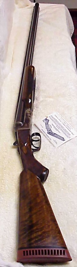

    This is reprinted at p. 148 in the Conley book from the 1931 Iver Johnson catalog:
    Here is my Iver:
  5. Bushmaster1313
    Bushmaster1313 Member
    Sep 13, 2009
    235
    Here is the open action.
    Action will not open with hammer cocked.
