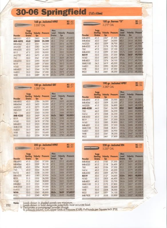

    Going through my reloading books...by the way getting the starter kit for xmas... I noticed compressed loads which tell me that the powder must be packed or compressed in the bullet. How do you do that. I am a bit scared as a begineer to try the compressed load. Any advise to ease my nervousness? Do you need a special tool of some sort?

    It's no biggie. If you have proper loading data it should not be a problem. Your loading press will compress powder the correct amount if you are using the correct measured amount. and proper components. The important thing is not start at the maixmun published load but work up to it, starting with at least 10 percent under maxiimun. If cases are sticky extracting or if primers or cratered then you have too much pressure. That is also the case if your group starts to spread out as you increase the power charge.

    Also, with a compressed load you need to be aware that different brands (or even different lots) of brass for a specific cartridge might have different internal volumes so a compressed load that is safe in one brand/lot of brass might not be safe in another batch of brass.

    Compressed loads are no "Hotter" than any other load. A compressed load is nothing more than loading with a powder that has a burn rate that is a bit slow for cartridge. To get the pressure and velocity up to where they belong ya gotta add powder. Does this make the load "hot" or dangerous. NO, not in the least, as long as you are following published data. Take a look at Hodgdon 30-06 data for example. Lots of loads and several are compressed. Are the compressed loads "Hotter" than the non-compressed loads? NO, running about the same PSI and in many cases running less PSI. Those that jump to the conclusion that "Compression" equals "hot" and "High Pressure" are simply misinformed about what a compressed load really is.
    I load for several rifles and if at all possible I shoot for compressed loads every time. Better accuracy and better SD. So, follow your manuals and if it is a compressed load, compress it, it will shoot just fine and I'll bet more accurate than your fast for cartridge non-compressed loads.
    Oh I almost forgot. Being compressed does NOT mean that you are loading to the Max published data. There are thousands of excellent compressed loads that are well below published max. Just another reloading myth, that "compressed" mean Max.
