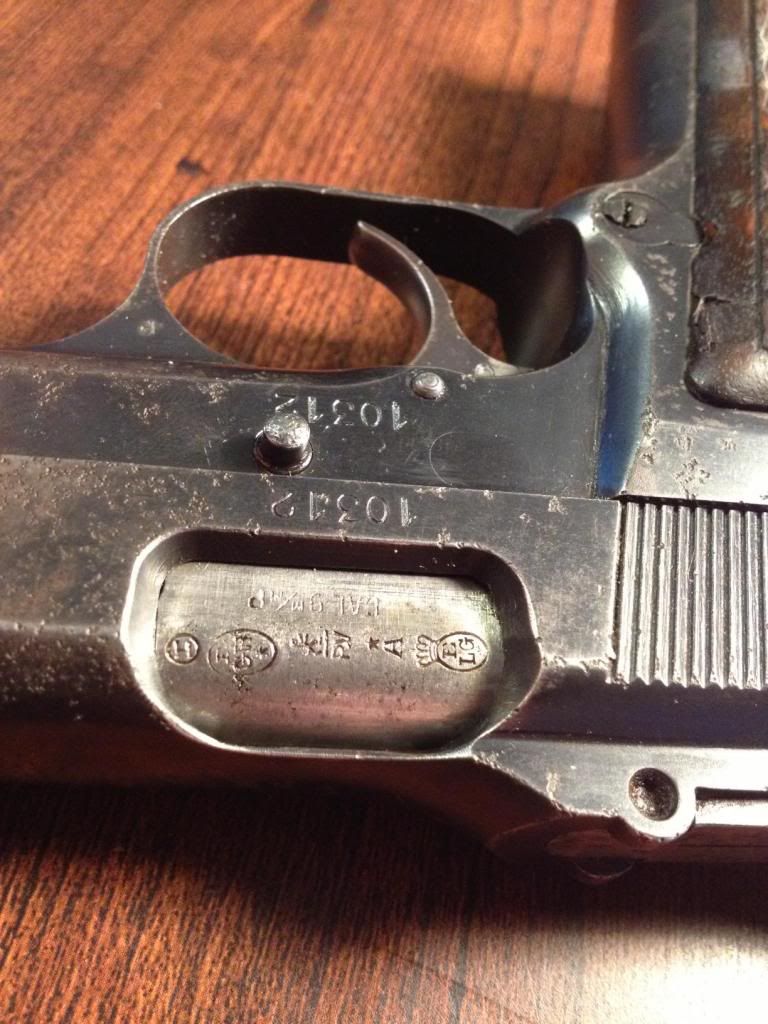

    My wife inherited a BHP from her father. She wants to know what all the markings mean. I have been able to locate the meanin of most of the markings and based on S/N I guess the gun was made around 1938? All S/Ns match. The main question I have is, where most of the guns I have seen pics of have an upper cas E with a star above it, this one appears to have an upper case A. Does anyone have any info on this and/or any other info on the gun. Thanks

    You have a Belgian military Hi-power made around 1937-1938.
    It has all the correct proof and acceptance markings, including the crown/a marking that you are referring to.
    These acceptance marks changed as a new inspection Army officer was assigned to the factory at different times in the production run.
