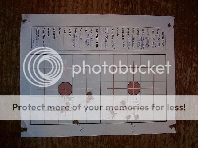

    Well the rain held off today and the wind wasn't blowing so I loaded up my gear and headed to the range. I took my handloads to see how they would do and I also took some factory ammo to compare with.
    These are my handloads. Not great but I'm not a great shot anyway.
    Here are the two togather. The left is the factory ammo and the right is my own handloaded ammo. I got a .300" better group out of my stuff. It is a start anyway and I still have all my fingers too!!
    Load data:
    Remington once fired brass fully resized
    Winchester Large Rifle Primers
    56 grains of H 4350
    155 grain Nosler Custom Competition HPBT
    3.300" OAL
    Factory ammo:
    Winchester Power Point
    150 grain
    Rifle:
    Ruger M77 Mk II
    .30-06
    Conditions:
    Warm and humid, cloudy skies, no wind.

    Congratulations on your first handloads! It will probably only get better as you figure out what recipe your rifle likes.
