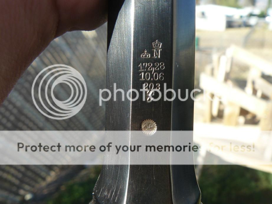

    From the research I did H. Burgsmuller & Sohne was a German "mail order" and custom company that mainly did double barrel shotguns or side by sides and pistols. From what I have read (little that I could find) they made custom mauser 98 action rifles up until 1914. Not by no means am I saying that this is what I have, just trying to get to the core of what I have. This is a picture of the stamps that may help find things out but I am still having trouble with them. Thanks for the reply's from all! I did cross out the last three digits of the serial number on the action and barrel. The crown with the N under seem to be since 1950 & nitro proof? also, what is the crown in the far left and the letters and numbers telling me? Thanks Again guys!

    The proof mark indicates the normal load is 2.75 grams of rifle flake powder, which is 42 grains, with a steel jacket bullet. That is in the 8x57 range. The proof marking also would be pre-1939. Oddly, the bullet weight and caliber are not given as they normally should be, and the marking is on the receiver, not on the barrel.
    As to sporterized military, I am not absolutely sure, either. The thumb cut is not definitive as Mauser Sporting actions might or might not have it. There are other clues but they would be hidden under the stock. I do doubt very much that any small maker "made" Mauser actions, though thousands used them and customized them.
    Another oddity is that while the scope is German, the base is American and mounted too far forward.
