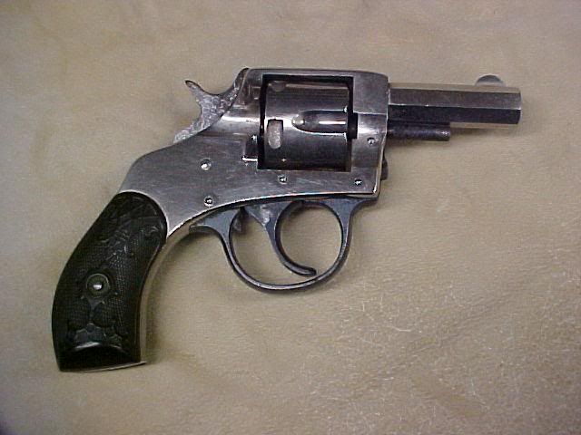

    This little revolver is in good working order. Lockup is solid and timing is fine.
    From what reading I have done on these, I believe that this piece is manufactured as a "smokeless powder" firearm; however, I do wonder what an "acceptable" modern round (if there is one available) to fire in this firearm would be.
    Although it is "retired" it seems to be quite operational and safe and I would someday like to put a few rounds through it.
    Apparently, it has not been fired much as the bore looks very clean and "crisp".
    The grips are in great shape with no cracks or chips - the nickel is in good condition overall.
    Serial number on the butt (and also under the left grip) is 501664
    I am wondering what the approximate date of manufacture would be and also what it's approximate value could be.
    Thanks... Here are some pictures:

    this is a late production medium frame young america revolver the cartridge and caliber is 32 S&W which is still loaded by several ammo manufacturers. there are no factory serial number records on this model but i would guess it is form the 1930's.
    YOUNG AMERICA DOUBLE ACTION SECOND MODEL MEDIUM FRAME .32 S&W CALIBER- 1905-1941
    5 shot cylinder capacity, pull pin cylinder release, Nickel finish, blue optional 2, 4½ & 6 inch barrel lengths, will have caliber and company name &
    address marked on side of barrel, Top strap will be marked “YOUNG AMERICA DOUBLE ACTION” or “YOUNG AMERICAN DOUBLE ACTION”
    After 1930 listed in catalogs as; YOUNG AMERICA No. 73 DOUBLE ACTION .32 Rimfire short 5 shot & YOUNG AMERICA No. 74 DOUBLE ACTION .32 S&W 5 shot
    VALUE: 100%=$225 60%=$65
    For all Young America Double Action variations and variants add 15% premium for blue finish and 10% premium for 4½” or 6” barrels.
    bill

    since this is a very small and lightweight revolver i would think the lighter the load the better. if you have the proper barrel cylinder alignment the flat nose bullet should not be a problem. just be sure and have a good hold on it when you fire because even the 32 S&W round is going to have strong recoil in this revolver.
    iver johnson once made a 22 short revolver so small it was hard to hold on to during firing and even the recoil from the 22 short was painful.
    bill
