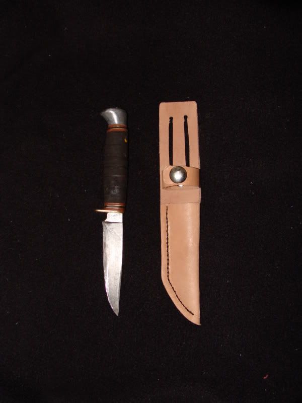

    A while back my friend Dave's wife Christl was telling me that Dave ( who is also a doctor in town ) found a knife when he was a kid and he's kept it all these years. She said he loves that knife and takes with with him all the time when he goes fishing but didn't have anything to carry the knife in. So I had her sneak Dave's knife out of the house and I made him a sheath for it so she could give it to him as part of her anniversary gift to him. Here is the knife and sheath I made for him.
