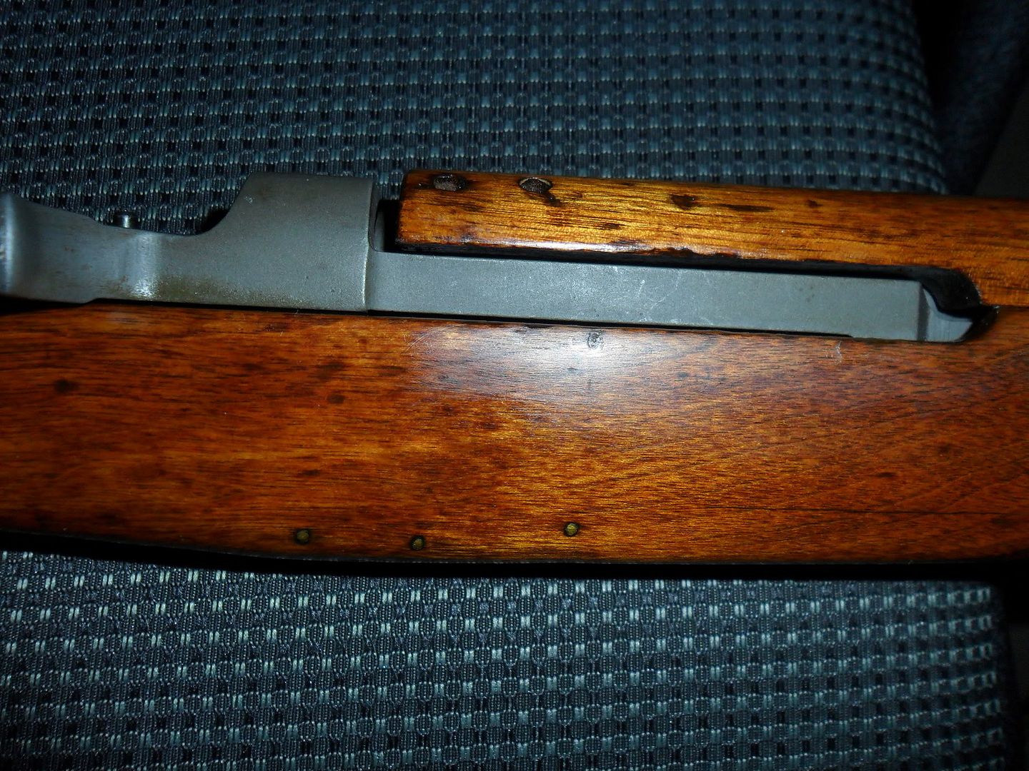

  4. wonderwhippet
    wonderwhippet Active Member
    Jan 10, 2003
    1,712
    The IO stamped inside the cut out means the stock is Inland, which may or may not be correct for your Underwood. I will look it up and let you know later today. Otherwise, so far everything looks good, so it may be an untouched early carbine worth well upwards of $1000. Did you find any markings inside the handguard, and does the handguard have two rivets or four?

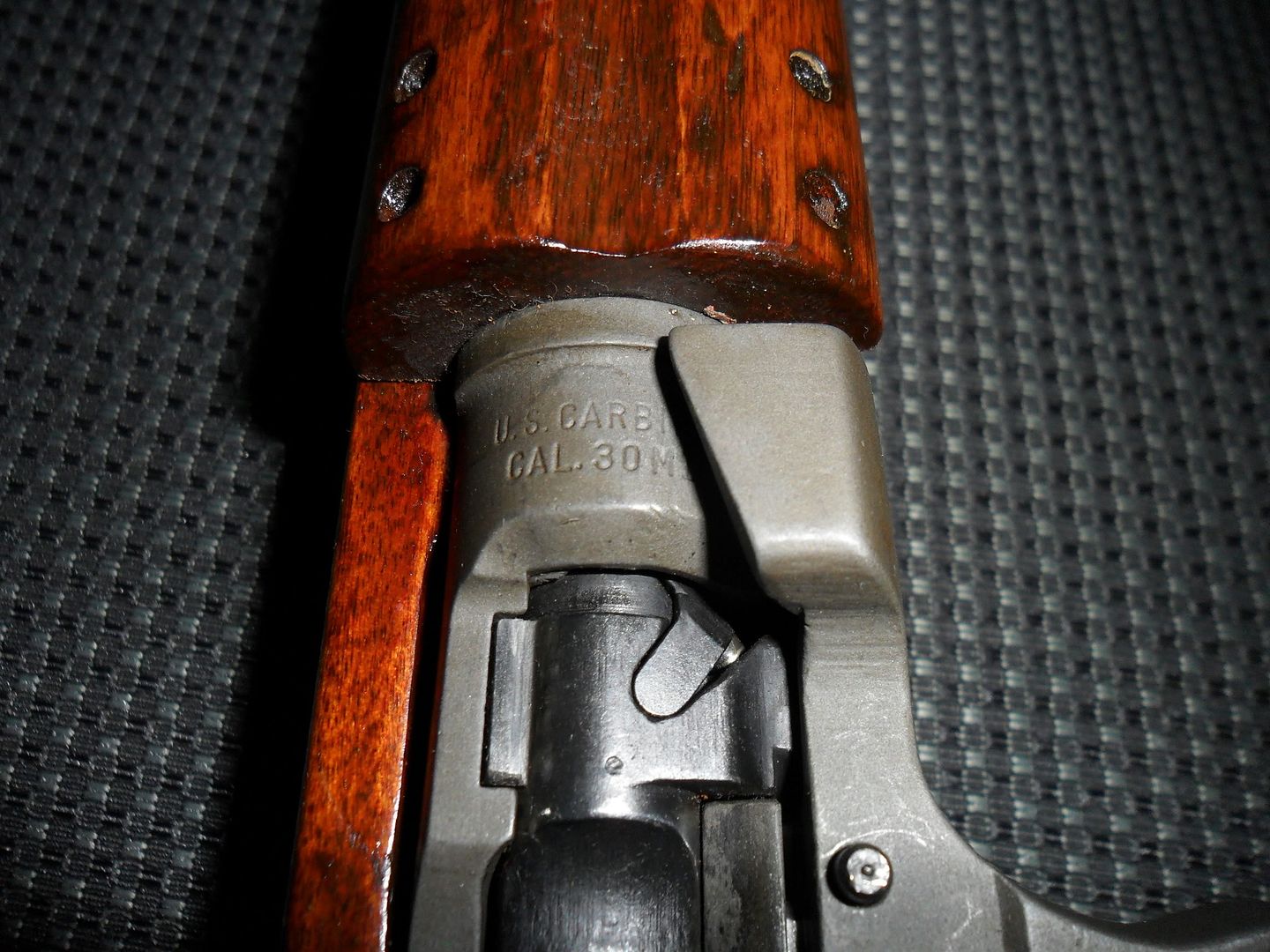

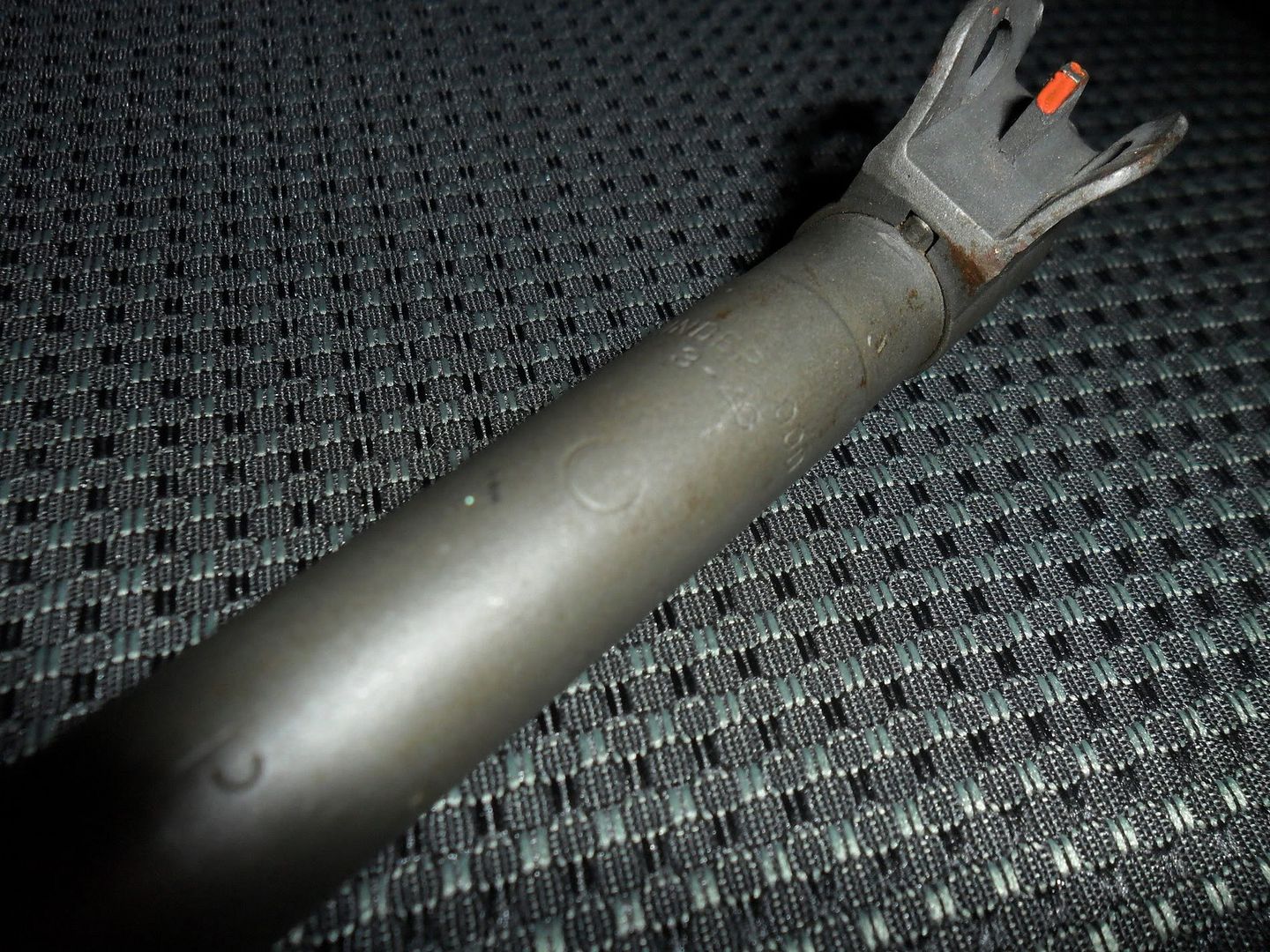

  7. trashman611
    trashman611 New Member
    Jan 9, 2011
    4
    Here are some more pictures of the front. Hopefully they can help some.
    I didn't find any markings inside the handguard, but I may have just overlooked them. A lot of the markings so far have been pretty faint and hard to see. The handguard has 2 rivets though.
    And I don't have a clue whether it was restored. No one I asked said that they restored it, but my godfather passed over a decade ago so there is always a possibility that it has been touched up.
    Thanks for all the help though. The more and more I try to look up the more confused I get. You guys are a lifesaver.

  8. wonderwhippet
    Jan 10, 2003
    1,712
    The front band looks absolutely correct. The two rivet early type handguard is correct, but I'm sorry to say the stock is incorrect. It looks like you would have to find an Underwood stock to make things right, not an easy job to do. The stock cartouche is a round 1/2 inch circle with crossed cannons. It is found on the right side of the stock, right under where your chin would be if you were aiming the carbine. Sometimes these have been very faintly stamped, or may have been sanded off, so they can be very hard to see.

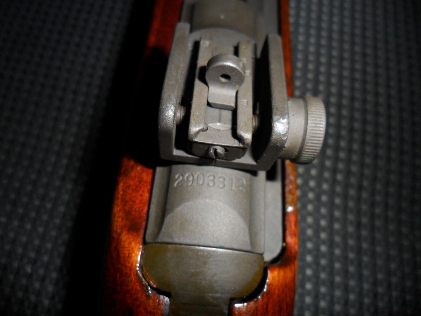

    Hello all,
    I'm new to forums & while searching M1 Carbines Underwood 3-43 I found this thread.
    I am seeking support from fellow members identifying my Fathers rifle.
    RIP Chief Alt 1924- 2011, USN 1940- 1971- 33rd Degree Mason A victim of Project Shad
    The rifle-
    ------------[​IMG]
    I was also given a MODELO 1935 Mauser in fine condition with old leather rifle strap : )
    Thanks in advance for any information : )
    J:D

  13. wonderwhippet
    Jan 10, 2003
    1,712
    Your carbine is a postwar rebuild, not considered collectible. However, it is a shooter and worth between $550 and $700, whatever the market will bear.
