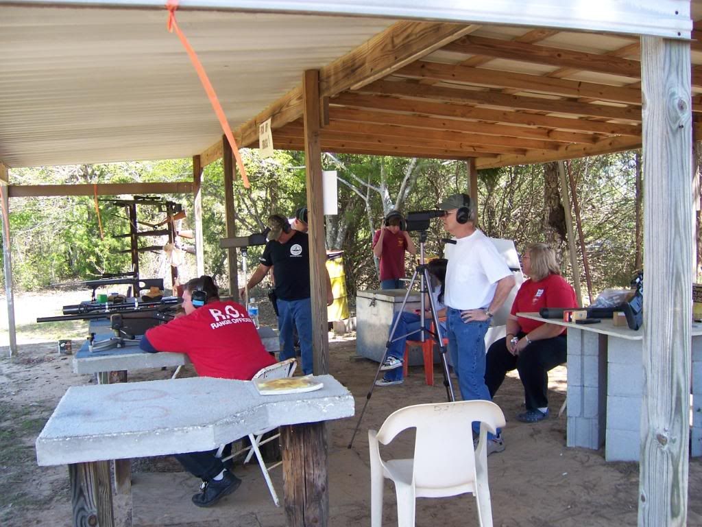

  15. Gabob
    Gabob Well-Known Member
    Dec 5, 2005
    1,455
    SW GA CSA
    Here is a picture of my range. Tables are conrete. We made a mould and a friend who owns a concrete company would put left over concrete in the mould when he finished a job. The tables are suitable for either right or left hand shooters
