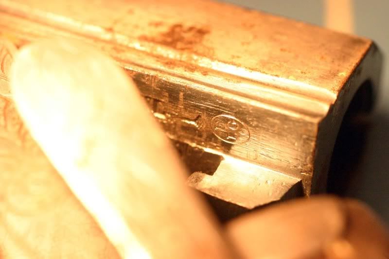

    What I saw last night as a crowned D is in fact a starred D!

    I have absolutely no explination of the Liege proof mark. And what is odd is that there should be at least a couple more proof marks other than the liege. Starting to think maybe its not a liege mark.
    However I did find a value in one of my "OLD" books. $4,000 US
    Please remember that by seeng the pics. We are making an educated quess and I most certanly can be wrong.

    The ELG Liege proofmark may be on underside of barrel at breech end. (Maybe can be read with a mirror?)

    If there was a market anywhere in the world for a gun, no matter how odd or unusual, the Belgian makers would try to fill it, so I would not rule out a Liege source, even if similar guns are known to have been made in Argentina.
    The "perron" alone on the breech indicates final black powder proof; the oval ELG will normally appear on the barrel. The "star [letter]" is the initial of the inspector and can be any letter.
