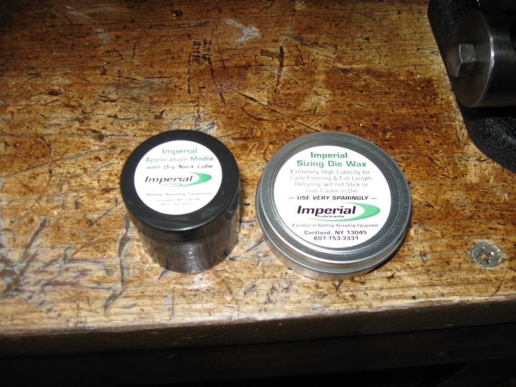

    Some people (like me) re-size on a non-progressive and finish the process on the progressive. If you choose to perform the entire process on your progressive, it can be done using non-adulterating (for lack of a better word) lube:
    Lube your cases externally w/ Imperial Sizing Wax and the inside of the necks w/ their Dry Neck Lube or machine mica. Run the case thru the entire loading process and clean off the Sizing Wax. The dry neck lube will not affect the primer or powder so it doesn't need to be removed prior to seating the bullet.

    I load 99% of my rifle cases on a single stage press. The reason being that I rarely load more than 100 rifle cases at a time. However, occasionaly I will load a 2-300 223 and 308 cases. I use Imperial Sizing wax for a case lube. I have NEVER had a stuck case with Imperial and I HAVE had stuck cases with other lubes.
    I insert my sizing die on my progressive press and remove all the other dies and powder measure I size/decap all my cases and then put them in my tumbler for about 20 minutes to remove the lube.
    I then REMOVE my sizing die from my press and re-install everything else. I then prime, powder drop and, seat my bullets on my progressive press normally. I don't crimp my rifle cases. Works well for me.
