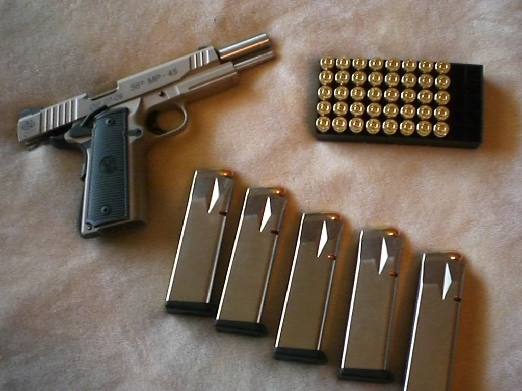

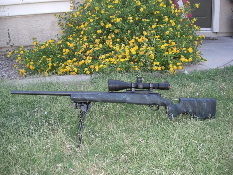

    I'm looking into doing some reloading on a few guns I have a para-ordnance 1911 double stack and a Kimber 8400 tactical (308).
    well I've never done any reloading before and was wanting to get into it. I guess I'm looking for advice and some recommended parts. I don't have much money to spend but still want quality tools.
    I'm looking to do hollow point for my 1911 and something more for long range with my Kimber say 600+ yards. I use my pistol 10x more then my rifle so thats mostly what Im looking for. i currently only use Remington UMC for range ammo and speer gold dot for daily carry.

    .....just wanted to say that's a sweet looking rifle. I've drooled over that puppy many a time while looking through the Kimber catalog, but I think due to my budget I'm going to end up with a Savage 10FP instead.
