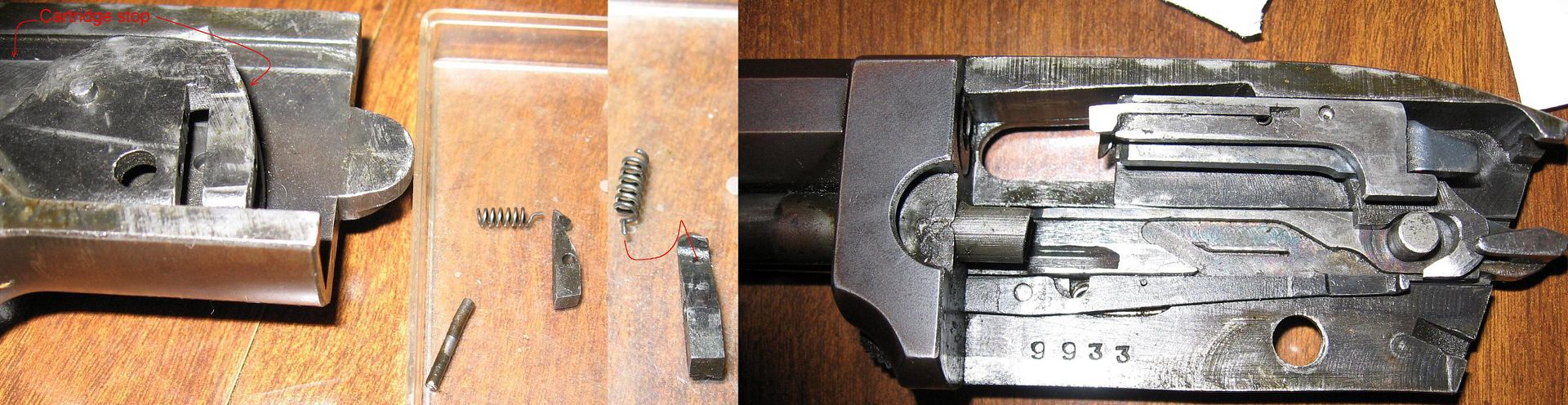

    Gunny; Steve sent me a PM, I only get on this forum occasionally. His comment on my knowledge of the mechanics of the Savage 22's failed to consider that of all the models the only one I have not sat down and took apart happens to be the 25!!!!... So I just sat down and started to take one apart. The piece you are missing is not the cartridge stop but a spring loaded piece that appears to snap over and ride in some of the grooves milled into the back side of the slide arm - this has something to do with how the carrier swings, exactly what it does cannot be seen.
    I took the piece out of one of mine and the first shell would go into the carrier and end up in loading position but the action would not close - the carrier would not drop, I could get the gun to function by pushing down on the carrier through the ejection port as I closed the action - that spring loaded piece's only purpose must be to get the pin in the side of the carrier to track through the grooves in the slide arm correctly.
    As you can see from the pictures that piece is very thin at the 'barb' and even has a small hole drilled through the weakest part.
    I would also look at the rear of your slide arm, it looked to me that I could have damaged those by forcing the action closed when I had that piece removed – make sure there is not damage to yours.
    The cartridge stop is the larger piece that mounts in the inside of the carrier - you can see it blocks the opening for a shell when it is up - when the action is closed it is forced down to open the carrier to accept a shell.

    She picked up the guns today and was happy with the results. Thanks again Steve and sav22. The part that sav 22 removed is called the action stop and indeed you can damage the action if it is not there. The cartridge guide is the spring piece on the back side of the carrier. You will notice that both of yours has a hook on the top, and mine does not. That hook covers the opening so that the cartridge stays in place, in the carrier. As the carrier move up, a relief in the reciever allows the cartridge guide to move away giving room for the shell to pop up into the bolt and then into the chamber. I had to make this piece, and the gun performs quite well. Her husband is due back in 5 weeks.
