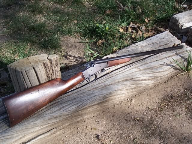

    a friend of mine has this old rifle. it's a j stevens model 1915 single shot lever action 22 rifle. my friend wants me to fix the gun up. make it a shooter.
    its in sad shape, it needs a firing pin, but i think it would not take much to bring it to firing condition. the stock needs repairing and needs a butt plate. and it appears that the front sight is made from an old silver coin. bore appears to be in good condition. im hoping it'll be a good shooter and he might sell it to me, but i doubt he will lol
    any suggestions on websites that will aid in repairs or that will give info on this gun would be appreciated.

    it does not lock up tight. the lever wont even go up all the way. someone has made a make shift firing pin out of a nail and i suspect that it's keeping the action from closing.
    huh, i thought for sure the front sight had been made from a coin because it has some faint marks on each side. cant see what the marks are but can tell it had something on it at one time.

    Check the extractor often it is worn and loose and will prevent proper lock up also worn lever Bushing & Lever Screw will cause the lever to flop around.

    okay. now that i think about it the extractor was flopping around.

    John, your rifle was definately made sometime after 1887, that's when the .22 Long Rifle cartridge came into being. Re-working that little gun will be fun. Remember that over the years there were a number of upgrades to the basic design. Make sure you get the correct ones for the vintage of the gun you have. I have had to just look at the remaining parts and then mach the missing ones to a sample gun or diagram. It shouldn't be too daunting.......there were a LOT of the little guys made. I overhaul some of these 'boy's rifles' when I stagger across them........some come to me in pretty sad shape, (see pics) like this little Winchester Model 1903. This is followed by a Stevens #14 1/2 'Little Scout' that I cleaned up a bit. It is chambered for .22 short only. It can become a fun hobby. Mike

    Hi, what you have is model 1915 Stevens.
    The earlist examples I have seen have a few minor differances than the one in your pics.
    the differances are
    rear sight is a buckhorn style
    the take down screw is a layard style
    no markings on the upper tang
    three or four digit number on the lower tang
    makers name only on the barrel
    no proof marks on the rec
    If I'm wrong then please jump in and correct me.
