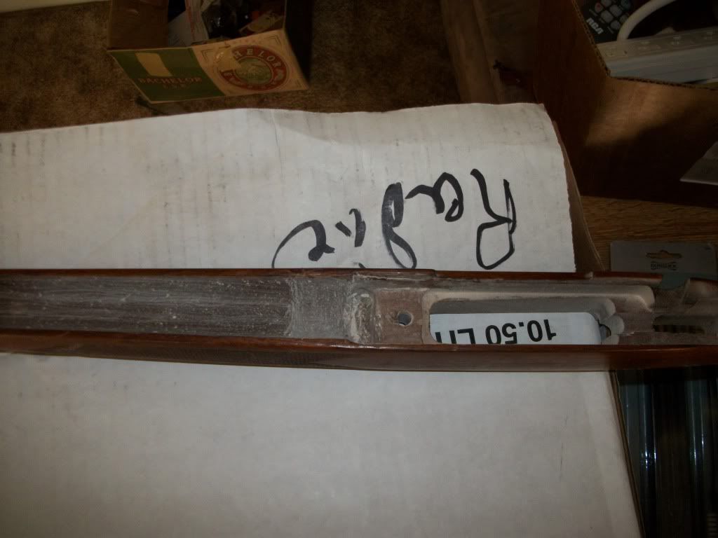

    Hi All. got a bit of a problem. I am getting ready to bed my Win M70, and what I am dealing with is fiberglass resin!:eek: At least I think that is what it is. I have already ground out close to 1/8th of an inch just in front of the recoil lug, and at least 1/16th of an inch along the rest of the channel. Now the main problem I have is that some of the resin is stuck to the bottom of the barrel! I know of course I can grind it out of the stock, but how can I get the stuff off the barrel? I don't want to hurt the bluing,which I hay go ahead and do anyway since it is all scratched up anyway! I guess when the resin flowed out of the gap between the barrel and the stock they nice dull knifes to cut it off! Look.
    [​IMG],
    This is just some of the scratches on the barrel! the bottom is worse.
    This is what the barrel challel looked like before I started working on it.
    [​IMG],
    This is it to this point.
    [​IMG],
    As you can see there is still a lot of resin in the channel! The area in front of the lug I have already ground out at least 3/32" of resin and it is still built up! Anyway to get back to my original question, How do I get this stuff off the bottom of ths barrel so I can use some Oxpho blue to at least cover it up some!:eek: Any ideas would be welcome! Thanks! Doug

    scrape it off with a knife or a razor blade, carefully. You are probably going to scratch the bluing, but if its already all scratched up whats a couple more scratches gonna hurt?

    Pick up some Goo Gone. http://www.googone.com/
    Should be able to get it at any hardware store or wally world. I haven't seen to much it can't dissolve. Maybe it'll work, but its great stuff to keep in the shop regardless.
    I used it to remove tape glue from a blued Makarov pistol not long ago and didn't bother the finish at all.

    It all depends on the epoxy or resin used and how well the metal was degreased but I've had very good luck popping thin epoxy buildup off of metal using just an old credit card or some other nice hard plastic scraper. Stuff the metal in the freezer to get it good and cold and start working on it as soon as you pull it out. The colder the better.
    Also, while it's cold, if you don't have a nice square edge to get the scraper to start biting, tap around on the epoxy layer with the a brass hammer or punch. Use a sharp edge of the hammer/punch face to get a chisel effect.
    Yeah, it'll take a while but neither one will damage a blued finish.

    Lye will destroy epoxy. Dangerous stuff to mess with. So far (repeat so far) it didn't damage gun finish when I used it. Best try a test spot.

    Well I got it off! I was at Wal Mart and happened across one of the copper scrubbing pads, I figured copper was softer than steel, so that and a little WD-40 scraped it off and didn't hurt the metal or the bluing! So something to keep in mind for stubborn cleaning! Doug
