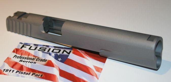

    It isn't getting caught by anything. The 1911 does the same thing......the case is coming back and smacking the slide behind the ejection port. That's why a lot of shooters like to have the area "relieved".
    See behind the port in this pic:

    You are right about the brass swinging on the extractor and hitting the edge of the ejection port when the ejector hits the rear left side of the head of the case. I see it in my brass all the time and can almost count the number of times the brass has been loaded by the little half moon marks left even after sizing. But....
    The marks on the rim tell me that the extractor is having a problem holding onto the rim. The extractor should act just like a hinge and allow the brass to swing out of the port and around the rear edge of the port where the brass gets hit by the edge of the port. I think in this case something more is happening because the rim is marred. The extractor is not holding onto the brass correctly would be my guess. But maybe not????? I'd have to have the gun to check it out to be sure.

    LDBennett, I fully agree; that's a pretty fierce looking extractor mark.......I think he has 2 problems happening at the same time.
