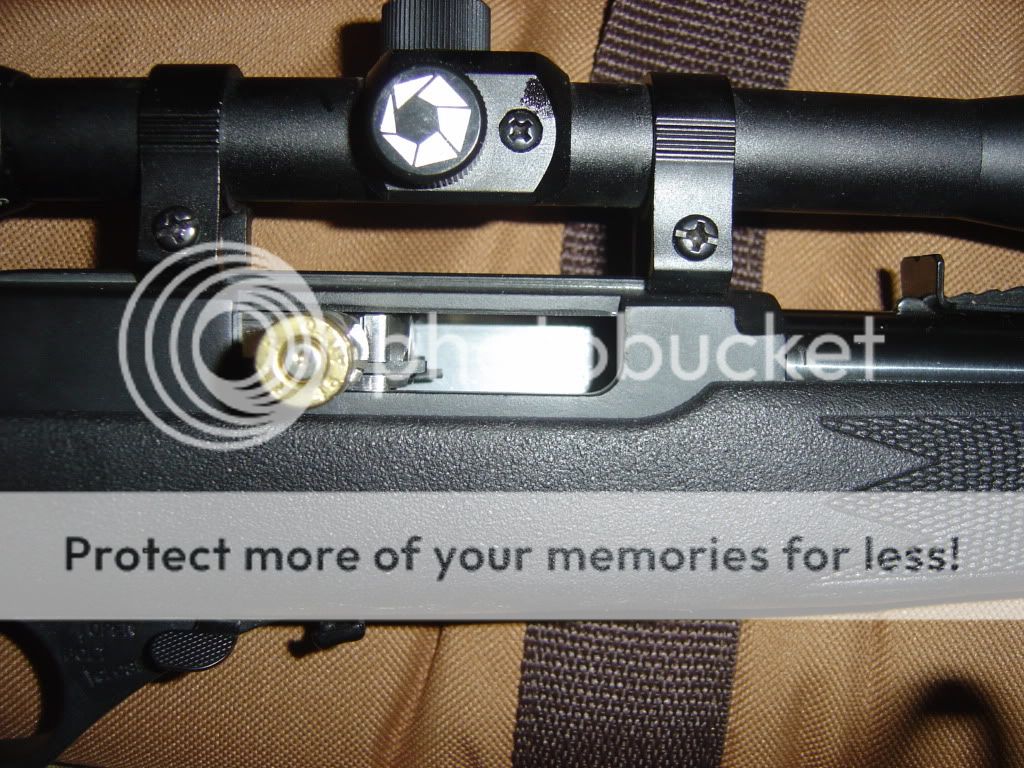

Or just get some JB weld and an empty case that fits on the bolt.
I have .45 case on my Marlin 795. A guy in another forum used a .30-30 just having to cut the neck down a bit to fit. That would give you an even longer handle.
On my brother's 795, I pull the bolt back with the right side of my right hand to lock it into place and close the bolt with my thumb. If your wife has carpel tunnel, like my mom has, perhaps a longer bolt handle would be appropriate. I kinda like the idea of a pistol or rifle case wielded to the handle, simple and effective.
