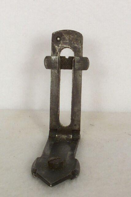

    polishshooter, the question was about pre-1900 guns, and my comments were about them also. If you look at his gun, you'll see it's a rifle with a common rear sight - U notch, maybe a semi-buckhorn or even a full buckhorn, with an elevator (hard to really tell, his picture could be bigger :)). Common "open rear sight".
    Look at the picture of the carbine, though (we'll see if this blown-up, fuzzy picture helps any) and you'll see that it does not have an elevator. The rear blade has a tiny little notch, and for longer range the sight flips up, giving you a ladder. Crappy sight.
    They quit making that sight by, at least, WW2. So even if you buy a fairly new 94 carbine in 45 Colt, it will not have the crappy carbine sight on it. It will have the rifle sight.

    This shows the difference between a buckhorn, a semi-buckhorn and a flat-top. See how the "horns" almost close together at the top on the full? Kinda hard to use, really, because it blocks out so much of what you are shooting, especially at longer ranges. The semi is much better, especially for quick shots. That appears to be what you have. For precise, the flat-top is the best.
    Here's a good shot of the carbine sight.
    And this shows you the great "shooter's view" of the carbine sight. Dinky little notch and all.
