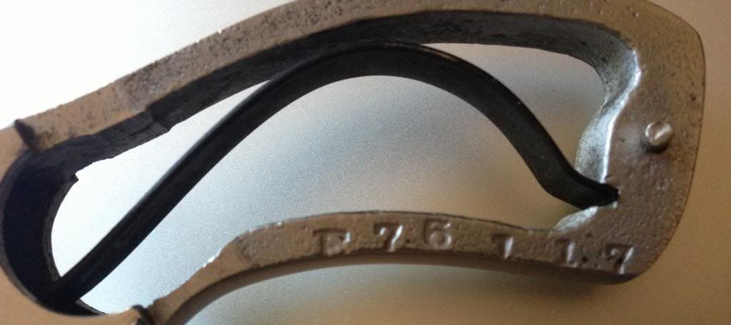

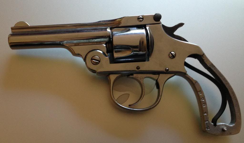

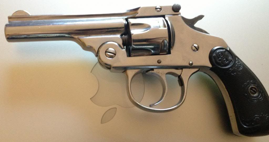

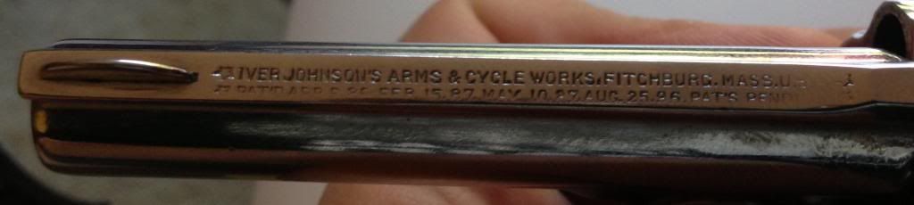

My father-in-law has this Iver Johnson revolver that he got from his mom. From my research on this fine forum, I'm thinking it looks like a Second Model, black-powder only, gun from 1898 or 1899. Am I correct in this? What else can you fine experts tell me?
Thanks, in advance, for your assistance!

The E serial number prefix was used twice on small frame .32 S&W caliber second model topbreaks, in 1898 and again in 1901, but the 1901 had an added Mar 13,'88 patent date, so yours was made 1898 and is a legal antique per U.S. federal regulations.
4 Posts
Discussion Starter #4
Thats for the help so far guys. I'm back at the in-laws for the weekend and got to talking about this again. I'm not an expert on older guns, so I was hoping for two more things:
1. How do I figure out if this finish is original?
2. What kind of value are we looking at here?
