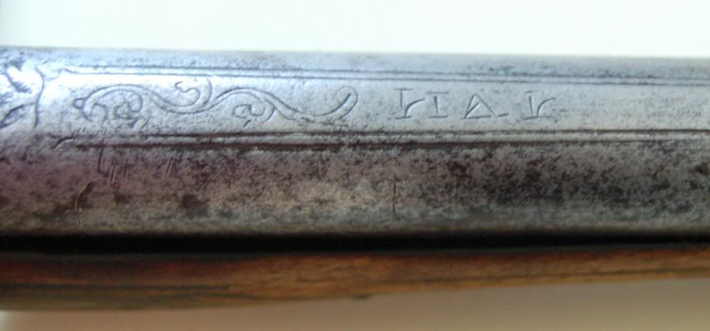

If you want to do something productive, try to translate the four characters on the barrel, pix next to last. It may be a stylized Arabic date. I have no suggestion as to how.
