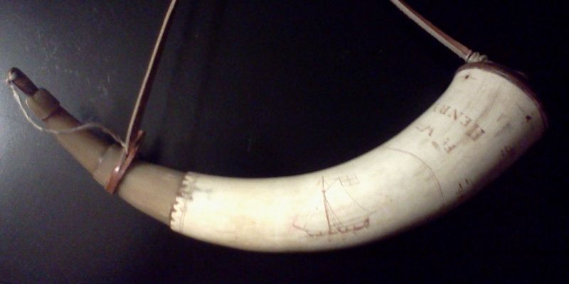

It's fun, ain't it? Yours reminds of one I built for myself a few years back. BTW, wooden toothpicks make good pegs for securing your base plug, and "engrailing" around the throat is easily accomplished with a small round file, or a Dremel tool....

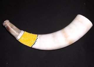

Nice looking horn.
Did you use the round file before squaring the end of the spout ? I worked on this one a while to get where I am and still have a long way to go. Also, where your strap connects on the forward end,is that engrailed ? I may end up doing it that way if I can't make a band from horn or wood. I do know that the band will have to be boiled if horn or soaked in water if I use wood to conform to the shape of the horn. I used square kitchen match sticks for the pegs in my priming horn. After a short soak in water, they go in the round hole.
I'm almost after the Southern Banded style but that may be too far advanced for a first time.
Thanks for the info and keep the ideas coming. I need them. :)
Sam is that a horn off a cow? Did u hollow it out or are they hollow?
Nice looking horn.
You could rasp out another section of your horn (shown in yellow) leaving a raised band to catch the horn strap. "Engrailing" is just decorative notches cut in where the throat meets the body of the horn. Not necessary, but it looks cool!
