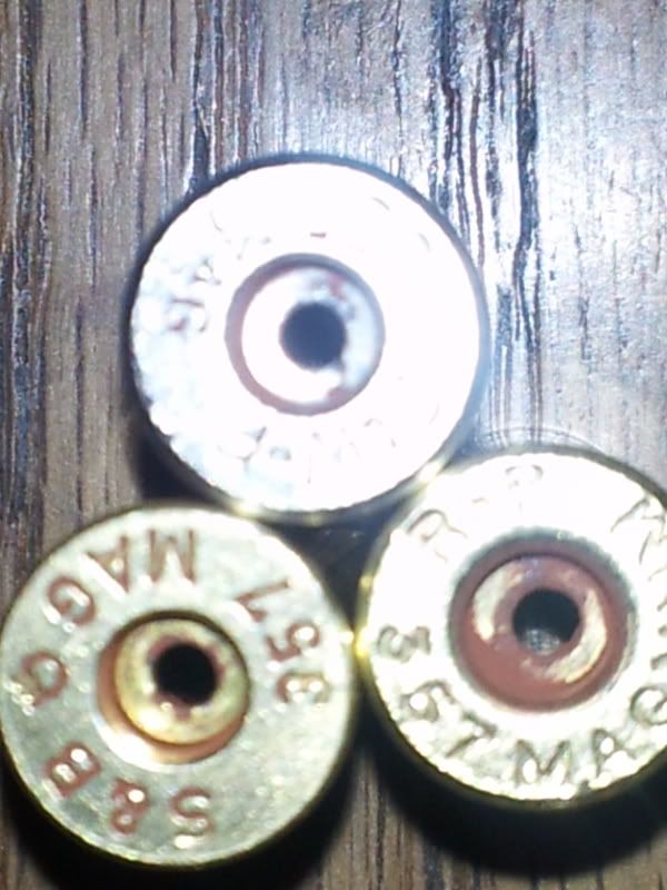

So I'm working on batch loading some 357 mag rounds, and came across some very tight primer pockets. I noticed a couple shells took a lot more pressure to seat the primer. One even had a small amount of shaved metal from the primer. The primer pocket on a few of these have no chamfer around the edge, they are straight walled. This is the best pic I could get of it, the one on the bottom right is normal the two on left are the tight ones. No problems that I remember depriming them. Any ideas, there isnt' many, should I just toss them?

For chamfering primer pockets (and removing military crimp/stake marks too), I just use my case mouth chamfer/deburr tool.
I've got some SB 9mm brass here that has the same style pockets. Very little chamfer and they are a bit tighter than the normal WW white box brass that I usually have laying around. Haven't had any problems with getting new primers in other than feel.
· Registered
18,561 Posts
S&B is very tight. Almost like it is crimped. I don't have any S&B 357, but I have a lot of their 38s. So the first time I get S&B brass, of any caliber, I run it through the primer-pocket-swager. Solves the problem.
I have found the same thing with CCI Blazer Brass, 45 ACP. No crimp that I can see, but the pocket is very tight. Primer-pocket-swager makes 'em perfect.
It's an extra step, but it's only one time, and they are fine brass cases.

I toss S&B brass for this reason and a few others; I stumbled across some 223 brass last night that had such little internal case capacity when I dropped 25gr Varget it spilled over! Usually for me when something goes wrong on the progressive it turns out to be S&B brass.
yep.. correct tool for correct job.
primer pocket cleaner, brush or blade style.
reamer for crimped pockets.
flash hole cleaner/true-er for mal formed flash holes or ones with debri or burs
pocket true-er to make sure pocket is cut to correct depth and diameter.
same tools are usefull for working on primers that were sealed primers with that red stuff..e tc..

You rock guys. It would have killed me to toss them out. I hate tossing brass. I'll run my chamfer tool on it.
