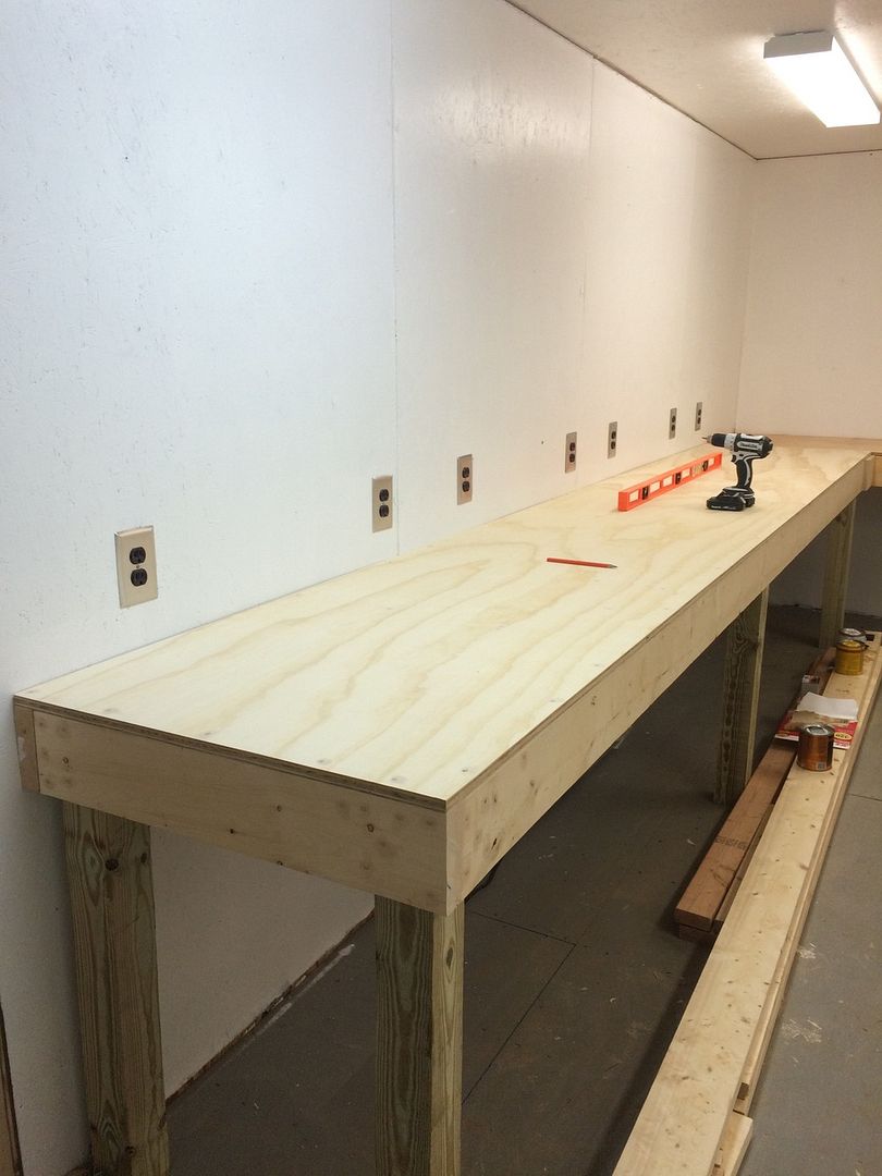

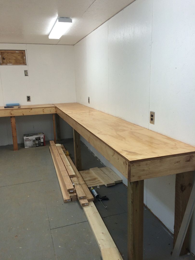

I didn't want to fill up "who's reloading tonight" thread, but here's an update on my building. I finally built my last bench tonight. All that's left is building my shelf below the benches, and stain/poly the new bench. We have baseball practice Tuesday, and I have Lodge practice Wednesday night. I hope to work on the lower shelf Thurs/Fri, and stain/poly Saturday. If so I should be ready to mount my presses, and drill press Sunday or Monday.
#4 ·
Thanks!
The bench top also has two 2x6's laying flat running the length of the bench giving the first 11" from the front a thickness of 2.25". There's also 2x6 joist running front to back every 48", and cut out to help support the 2x6's, and bench top.

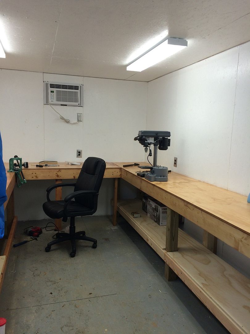

#6 ·
Thanks Todd51! It's actually a 10x20 building. I also need to get my A/C set in its hole. The setup will be presses on the left, and back bench. On the right bench will be a drill press, and Lyman Case Prep center. Then the front half of the right bench will be for gun cleaning/maintenance. I should have enough room to place my long gun on the bench for cleaning without them hanging over.

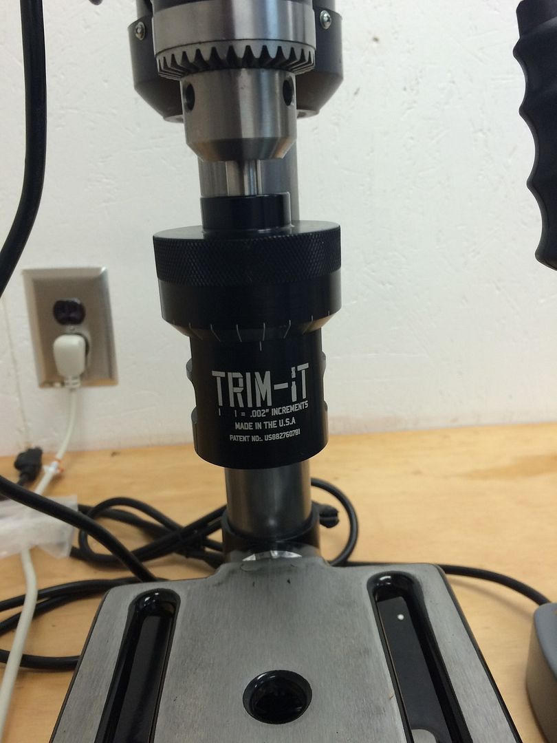

Soundguy here's my trimmer that I use with the drill press.
Thanks for the pic. I was guessing thats What you had it for. Nice trimmer too. If i
didn't have my rcbs power trimmer, id have done that as i have a spare small bench drill press.

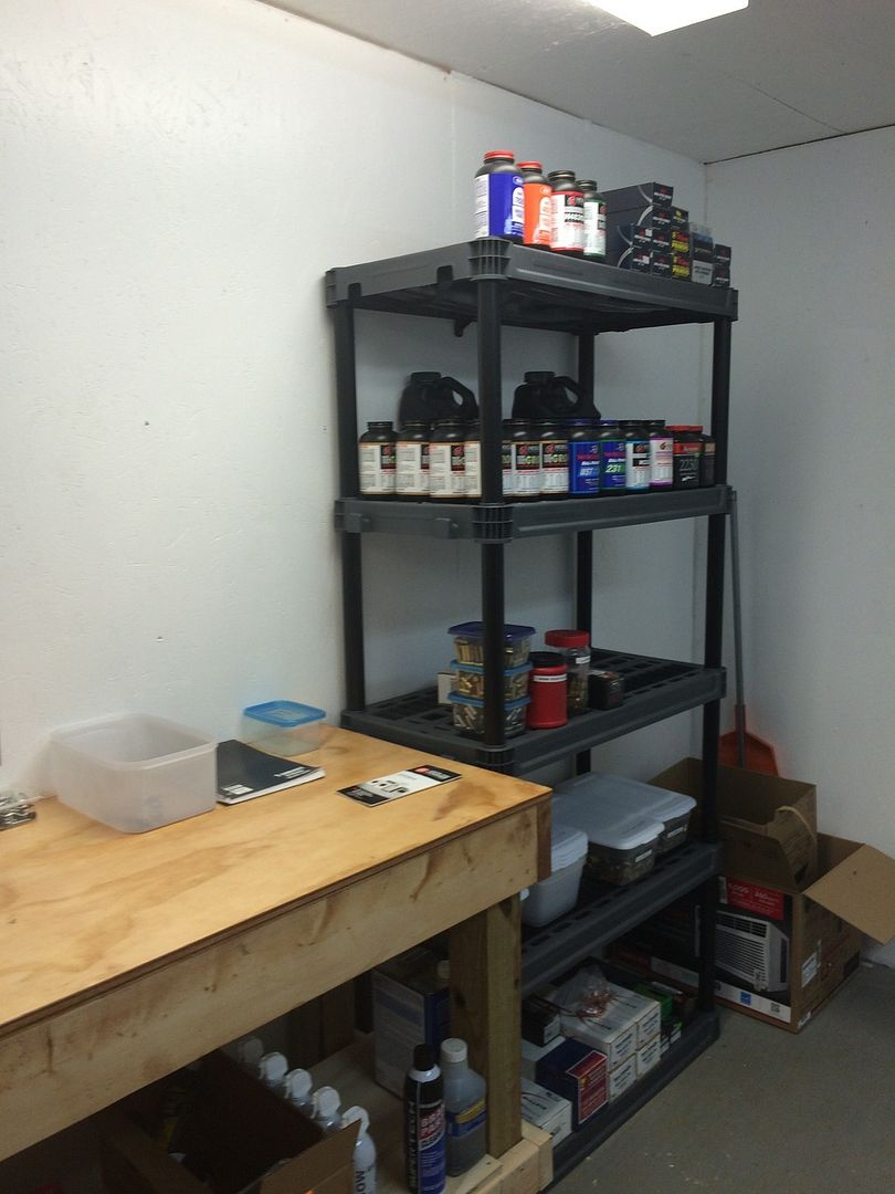

Gdmoody you are my inspiration on buying a building. I have moved all my powder, and primers out to the building. I had to buy a dehumidifier to keep the humidity down. I'm keeping it at 50-55% seems like that's the ideal range for no rust, and keeping powder/primers fresh from what I have read.

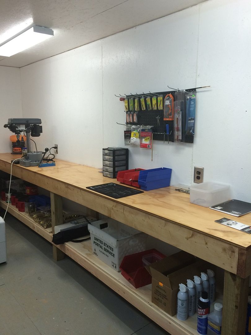

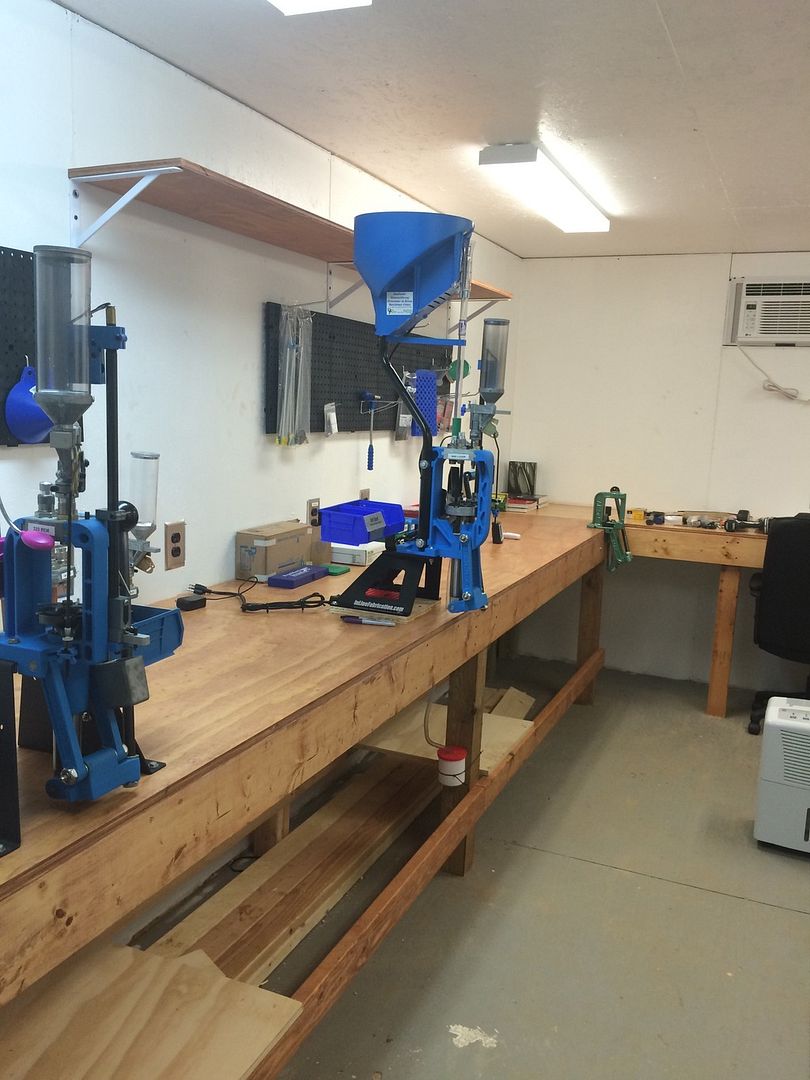

#32 ·
Looks like I have finished up for now. I plan to load some this weekend! I still want to hang some cabinets, and finish up with staining my lower shelf under the bench. Here's how things stand now.

#46 ·
Wow, its hard to walk after seeing those pics.. and I'm not thinking about arby's either..
Seriously nice, even them blue things bolted to the bench. :)
Yea I love my sea of Blue! After reading through pages of LDBennete talking about how good the Blue Koolaid was, I just had to try it! The RL550b was my very first press.
