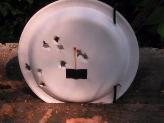

... and every time I take it out to shoot, I have to re-figure my POA.
The few shots to the lower left are me figuring out my POI at 50 feet. The few close to the center are taken at 40 feet with an adjusted POA, (one hit is with the others at the lower left.)

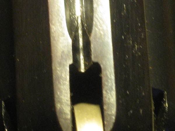

That is my rear sight v notch, it is not center but a little left and angled a bit. My front sight is a post apparently screwed in. I can't move the front sight from side to side, so I was thinking of filing the rear sight v notch so it is centered.
At 50 feet it is 6 inches or so left; which is hard to figure out where my POA is at varied distances.

Well, I can see that the v-notch is wrong, and with the tools available to me, I figure the barrel and front sight blade is square. Since I'm not going to pay anyone to do it, I'll take the easy route and file it so it is centered.

#10 ·
Filed and tested 3 different times over 3 days, I think I have it as centered as I am going to get it.
Off a Rest, Black Powder Pistol
I'll see how it shoots over time, hopefully that is all the filing it will need.

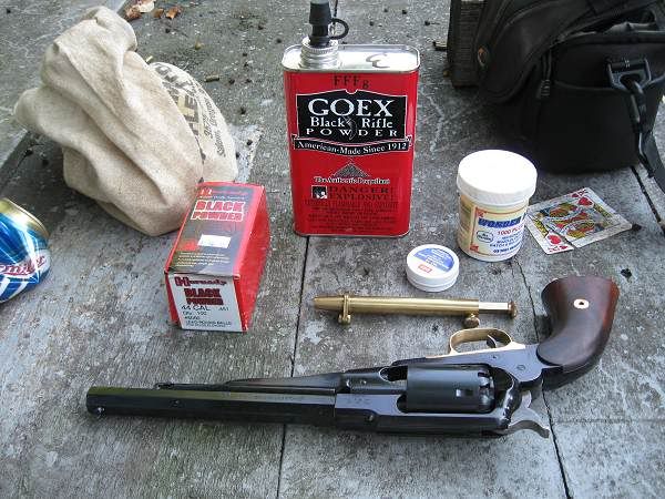

#13 ·
That looks pretty close. Better than I remember doing with my Pietta '58! I really need to dig it out and burn some charcoal again...it's been a couple years since I've shot it.
What load are you using? Diameter ball and how much of what powder?
Reading your notes on the YouTube page, I noticed you mentioned having a consistent couple of fliers every cylinder full. Did you ever trace them back to a specific couple of chambers or not?
#14 ·
I use a .451 inch ball 30 grains of powder and this time I used Remington #10 caps.
I am thinking I was not used to shooting it yet, because the last 4 or so loadings, all the chambers hit about in the same place. There is a lot of creep in that pistol and I think I finally got used to it.
