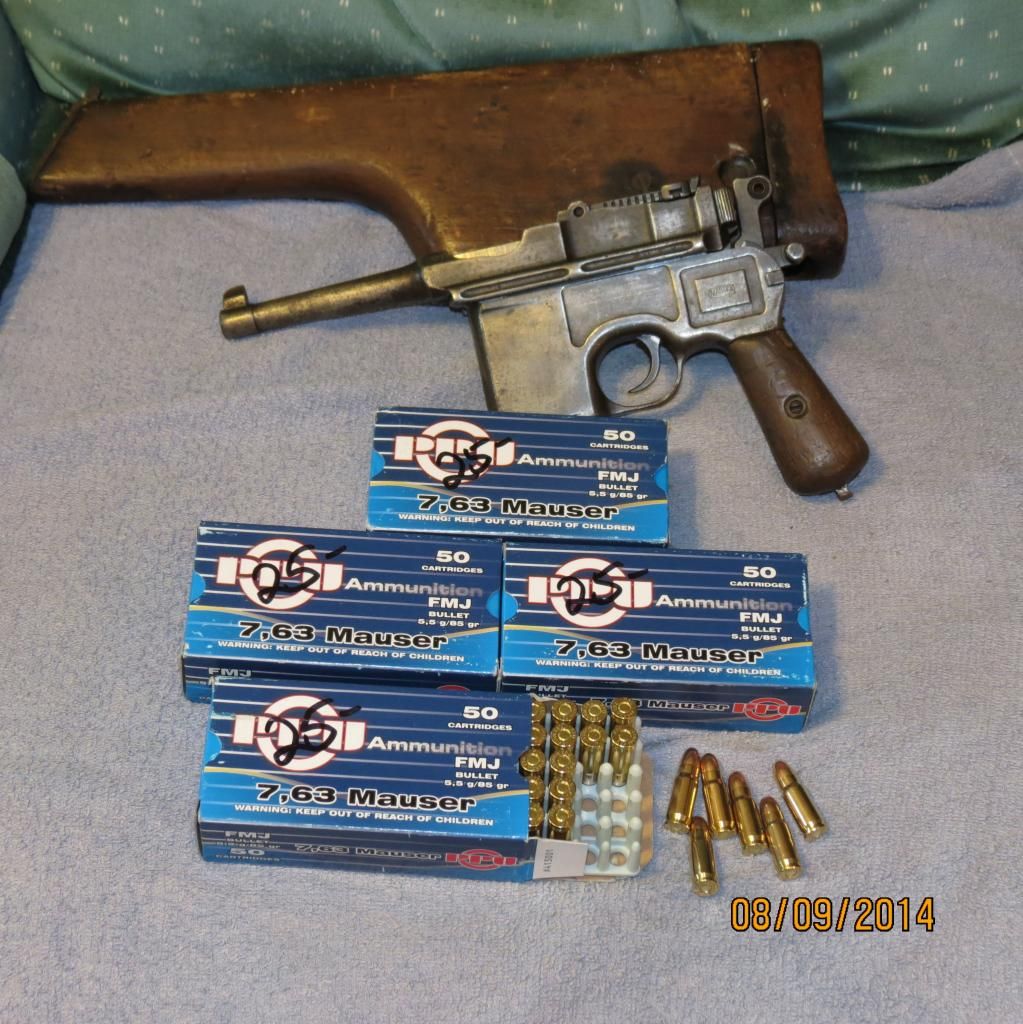

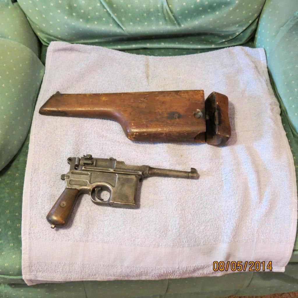

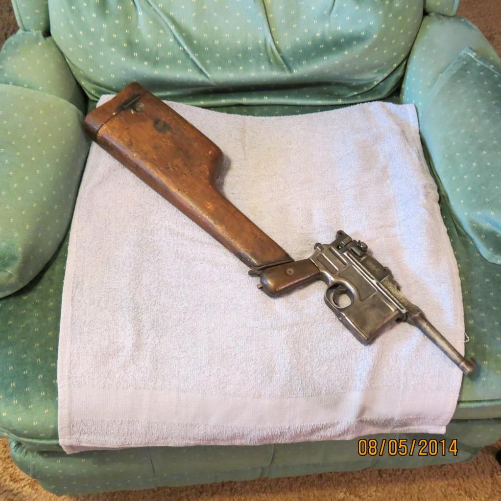

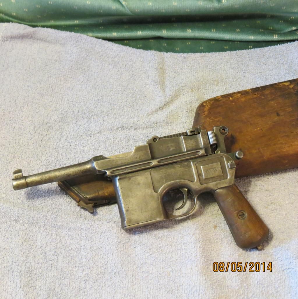

Thanks for your replies and I will adhere to them. I'll check the local gun stores and the gun shows to find the proper ammo for it. I just paid close to $300 getting it fixed so it can shoot, and the last thing I want to do is blow it or myself up. I'll take a few pictures of it later today and post them on here. :)

Many people make commercial 7.63 ammo. ppu/prvi fioochi at least a couple others.
